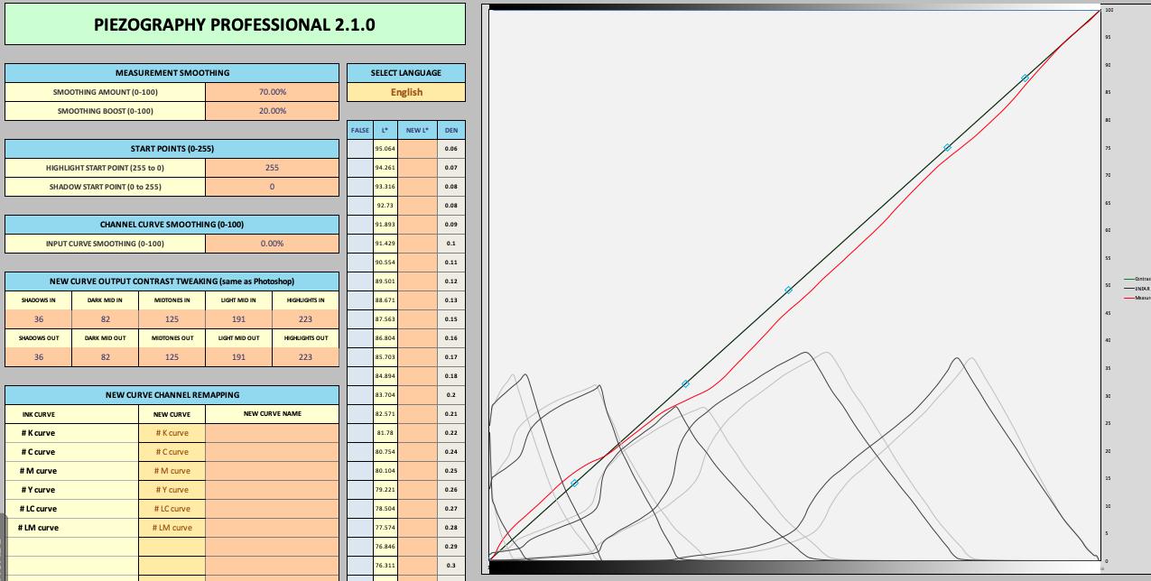

Ok, printed 700 dtp70 target with the installed epson enhanced matt curve and created a new curve, printed out proof of piezograpy image and it looks much better.
Have now printed off a 256 dtp70 target with the new curve and once dried overnight will will put it through the dtp70 and see what it looks like.

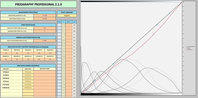

Hi, ok decided to start from scratch.
New dtp 700 target using the default installed epson enhanced matt, dried over night.
The curves on this seem very steep and abrupt?
black reading 18.307 - 1.59
any thoughts?

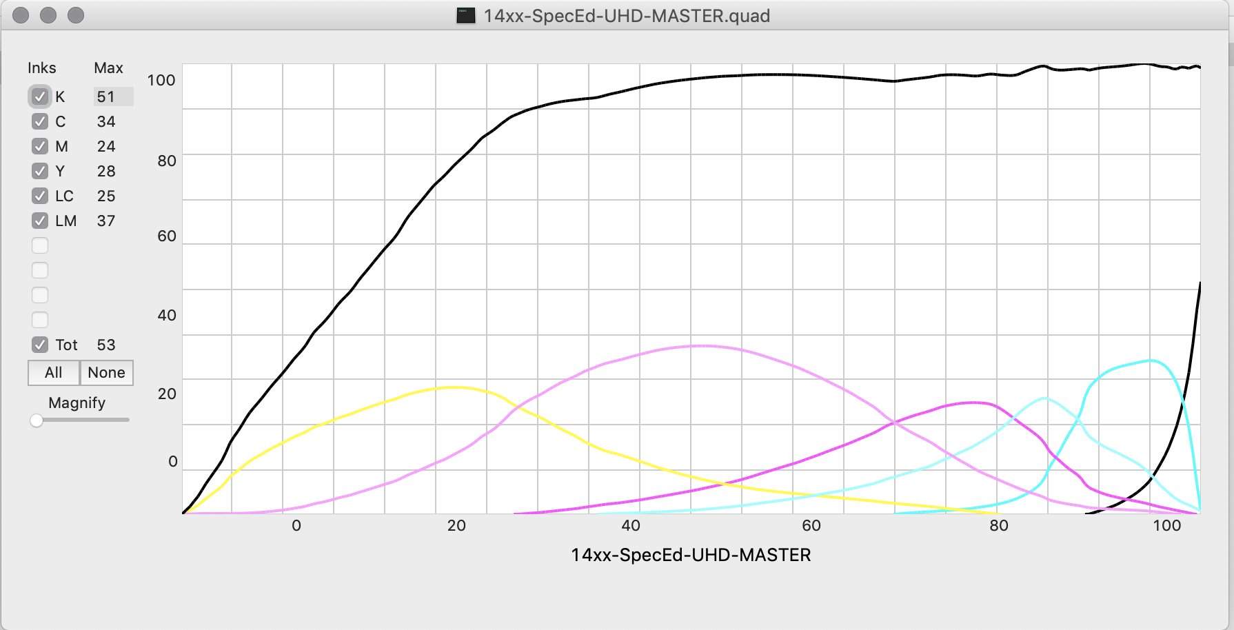

I think you should be calibrating with this .quad from the Curves-HD folder (on Mac) and Quad1400-HDK6 folder on PC.
14xx-SpecEd-UHD-MASTER.quad (5.8 KB)

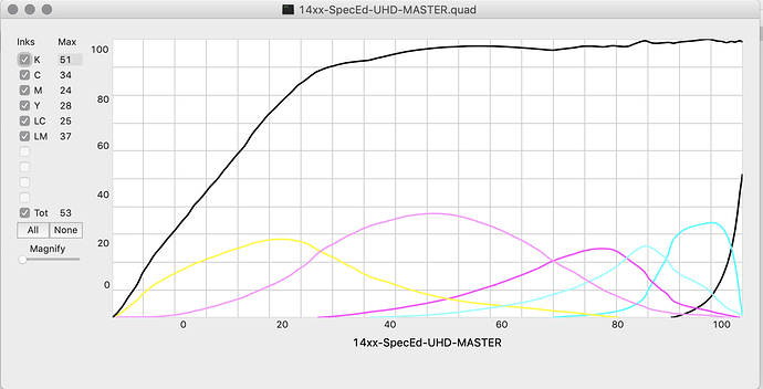

Here’s and even better smoothed master version:
14xx-SpecEd-UHD-MASTER-Smoother.quad (6.9 KB)
Great, many thanks will try this one.

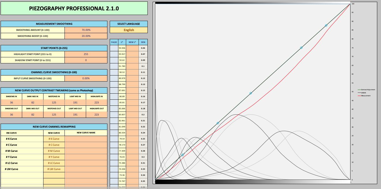

Ok tried this new curve, curves are not as steep, will create new curve and try that.
lowest reading
17.581 - 1.62
