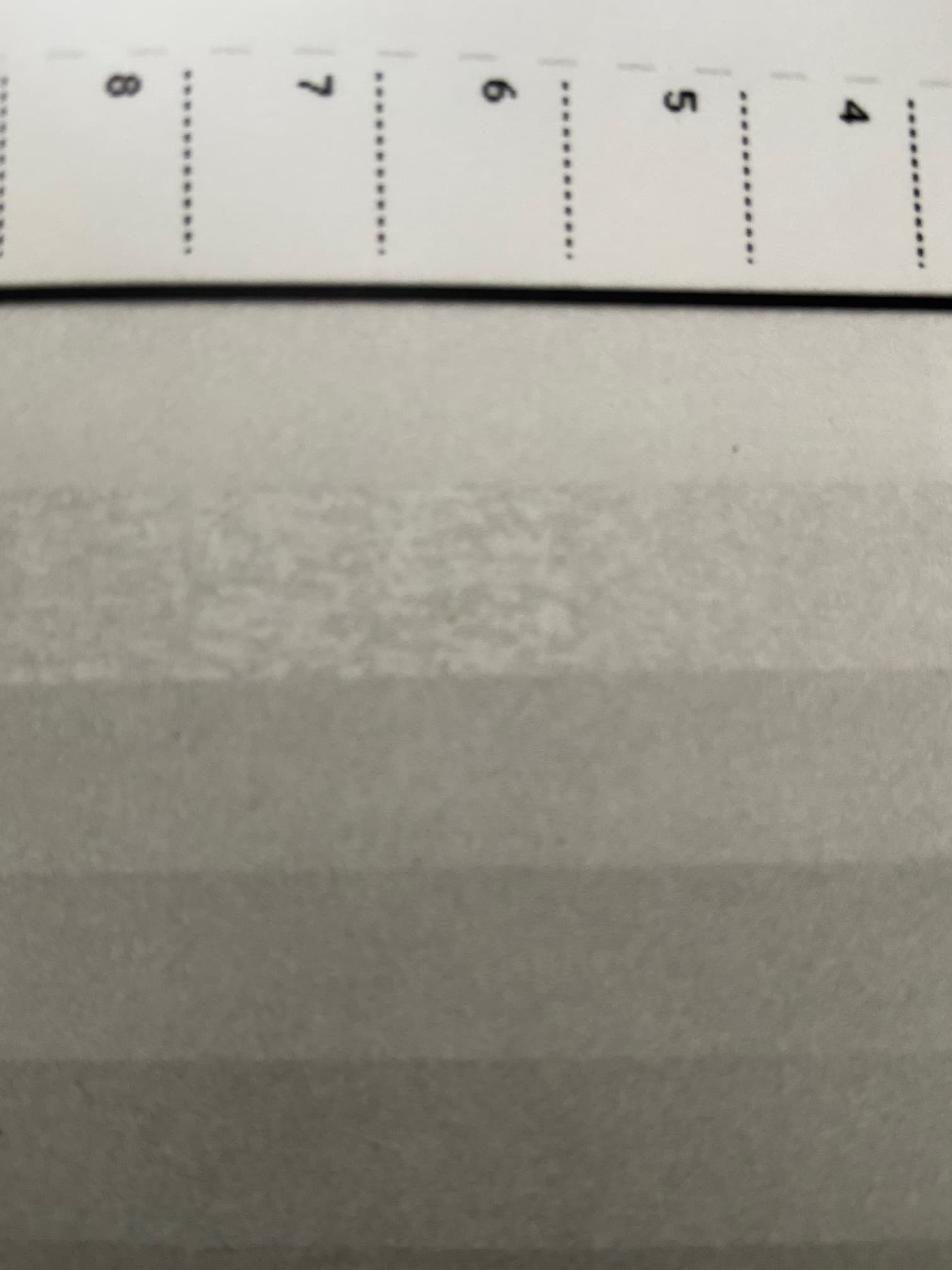

I tried using the Epson Display Trans using a 9900 with pro ink and Ilford Warmtone paper and got this weird mottling. In theory, it seems like it would work well. Any ideas?
Greg
It kinda looks like over-inking to me. You may want to lower the ink limit a lot and re-calibrate.
Yeah these are definitely the smoothest negs I’ve gotten. Don’t use my curves I posted necessarily, create your own from scratch (you will have to limit heavily to about 175 in my experience… I have no idea how the silver masters work for anyone they are so so dense compared to regular silver negs)
But anyway, if you haven’t already, you’ll want to calibrate your feed with a custom media type and all that jazz and do a head alignment before making negs. The noise is almost always from over-inking or feed issues. Sorry I responded like a year later lol
