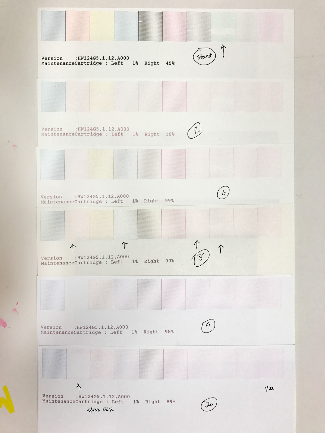

I have had a Epson 9900 with one dead channel, LC, sitting here for a few months with Piezoflush in it waiting for the new Pro inks to show up. I would run daily a nozzle clean and/or a nozzle check to keep the printer happy.

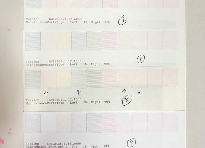

Yesterday I put the new inks in, did an init fill and have many bad nozzle patterns. Tried all the usual cleaning tips and even another init fill just to make sure all of the Piezo flush was out and the new inks fully in the dampers and head. Waited overnight for things to “settle”, still the same today.
What next? Why would I be getting all nozzles good except my LC before the ink change?

I see evidence of Yellow and Light Cyan in the nozzle check as well which should not be the case after 2 init fills.
Although the yellow may just be the shade 4 warm . . .

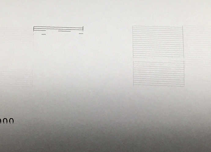

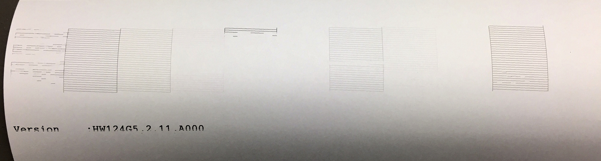

Everything at first seemed to be working well after an init fill. I’ve been working on this for 2 weeks, allowing the flush to do its thing on the GR channel, which is almost clear. At my 9th nozzle check I suddenly lost my OR channel completely. After several OR/GR cleanings I coaxed back a few stripes. I’ve run several printer purge prints and it appears that the OR channel is printing without banding, as far as I can tell with a Piezoflush print.
I don’t seem to be making any progress on getting a good nozzle check on the OR channel. Strange, in all my years of running this printer I never had a problem with OR, and have had issues with just about every other color. I have checked the OR cart and the top cap is tight, everything primed, etc.
Given the integrity of the purge print, could there be something screwy with the nozzle check? It’s strange that the channel dropped out completely and yet still manages to put out ink (apparently). I don’t want to proceed with loading my PiezoPro inks if I can’t get a clean nozzle check.
