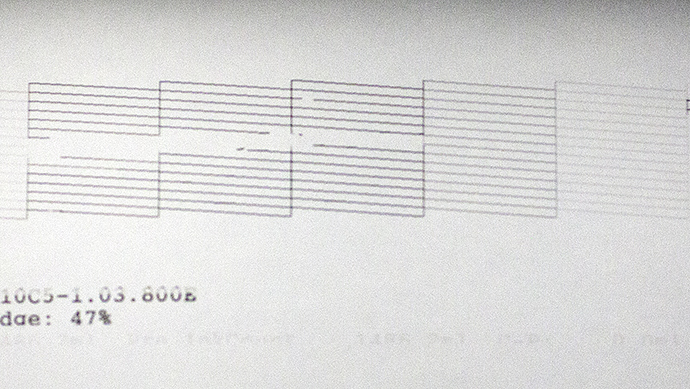

I am having trouble with my epson 3880. I have two of them and I am having the same trouble on both printers. I flushed the printer with Piezo Flush, and did a Print test with the piezo flush. The print pattern printed fine with the Piezo flush. Then I installed the Piezo DN-K7 inks and and ran a power clean, but no matter what I do I can get a complete print test. I have cleaned the heads with a paper towel (as the instruction video shows) with Piezo flush. At this point I am just wasting ink. Dose anyone know what else I can do?
Steven
Attached is the test print for the Piezo DN-K7 inks

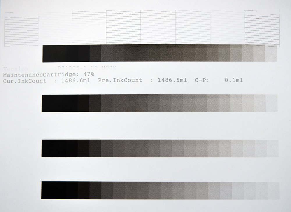

Here is a test that I did this morning.
The gradation bands of ink between the various nozzles on the check tell me that you have some cross contamination of ink at the dampers. They need to be pulled and put back on.
