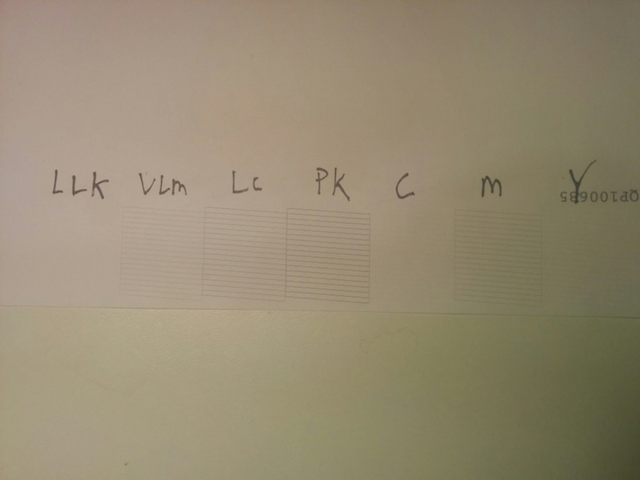

When I did a test page, the Yellow (Shade 7) and Cyan (Shade 2) checks came out very faint. The lines are there, just not as string as the rest of the heads (save for the LLK head which his the Gloss):
[attachment file=27070]

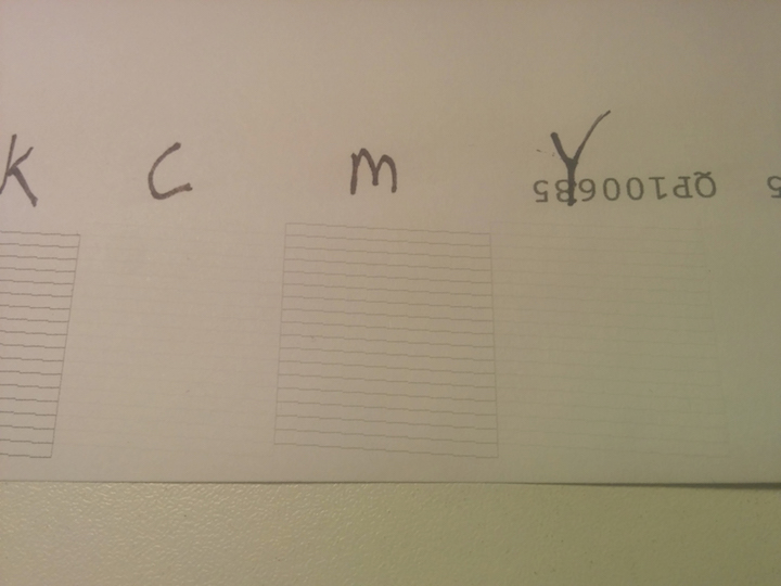

Here’s a close up. You can see the faint lines in Y and C:
[attachment file=27071]

Are you positive that your Cyan cart really has shade 2 in it? Maybe Im wrong, but I would think that your Yellow cart is fine with shade 7, but that you filled Cyan cart with a shade other than 2. Whatever is printing in the spot you’ve labeled C is not shade 2. Shade 2 is dark ink.
Also, where is your Light Black?

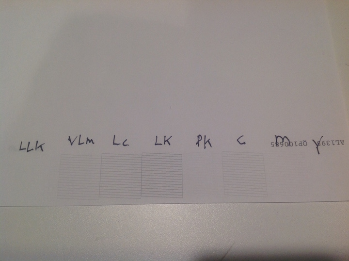

Thanks, James - you’re right, I messed up the images, above. Here’s the correct set of nozzle checks:
[attachment file=27076]
So - PK isn’t printing very heavily.
Y and M are pretty light as well.
I double check these things though - so I’m sure I didn’t fill cartridges with the wrong ink.
I see what you did. Epson doesn’t print the nozzle check in the same order as the carts are loaded. So on the picture of your nozzle check:
LLK is actually the yellow cart, which has shade 7
VLM is actually the magenta cart, which has shade 4
LC is actually the cyan cart, shade 2
LK is actually your PhotoBlack cart, shade 1
PK is actually your light black, shade 6
C is actually your light cyan, shade 3
M is actually your light magenta, shade 5
Y is actually your gloss.
7,4,2,1,6,3,5. where 7 is lightest ink and 1 is darkest.
So, provided all the lines look good, you are in great shape.
