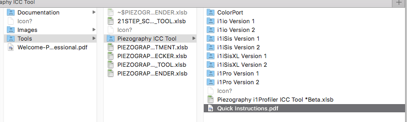

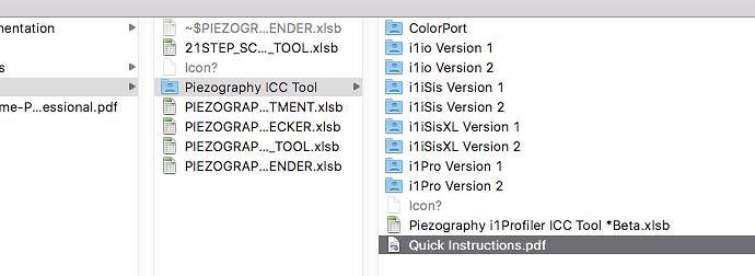

It’s in the grayscale management chapter.
However, if you want to simply use the i1Profiler workflow you can built Piezography ICC profiles with that with the provided Piezography ICC Tool found in your Tools folder. For consistency of workflow (for you) I suggest it.
Thanks - I know what you mean - but the description for how to create such profile is not there …
I think I stay with what I have - even with DG20. I have made a softproof profile via the measurement tool - which is running under Windows. No chance for doing this on Mac anymore.
Hmmm - never touch a winning team
Markus
It’s Beta still so not in the manual itself.
[attachment file=28953]
But yeah, if windows, just keep w/ soft proofs. (in general, whatever works!) :slight_smile:
