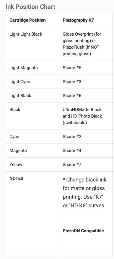

I’ve been watching the really helpful online PiezoDN course, but am a little confused about the discussion of matching ink installations and curvesets.
I am setting up a dedicated 3880 for digital negatives, and I ordered the K7/PiezoDN Selenium ink set for this.
The installation instructions that came with the inks have the cartridges in this sequence:
K7:MK
K7:PK
K7:S6
K7:GO
K7:S2
K7:S4
K7:S3
K7:S5
K7:S7
As I understand Online Lesson 1, Matte black isn’t used for DN, and Photo Black goes into the Yellow Channel, where I now have K7:S7 installed.
I think I also understand that the K7 curves would match the way I have the cartridges installed, but that it is preferable to use the PiexoDN P2 curves for DN. Should I move the cartridges and chips around, or just use the K7 curves instead?
