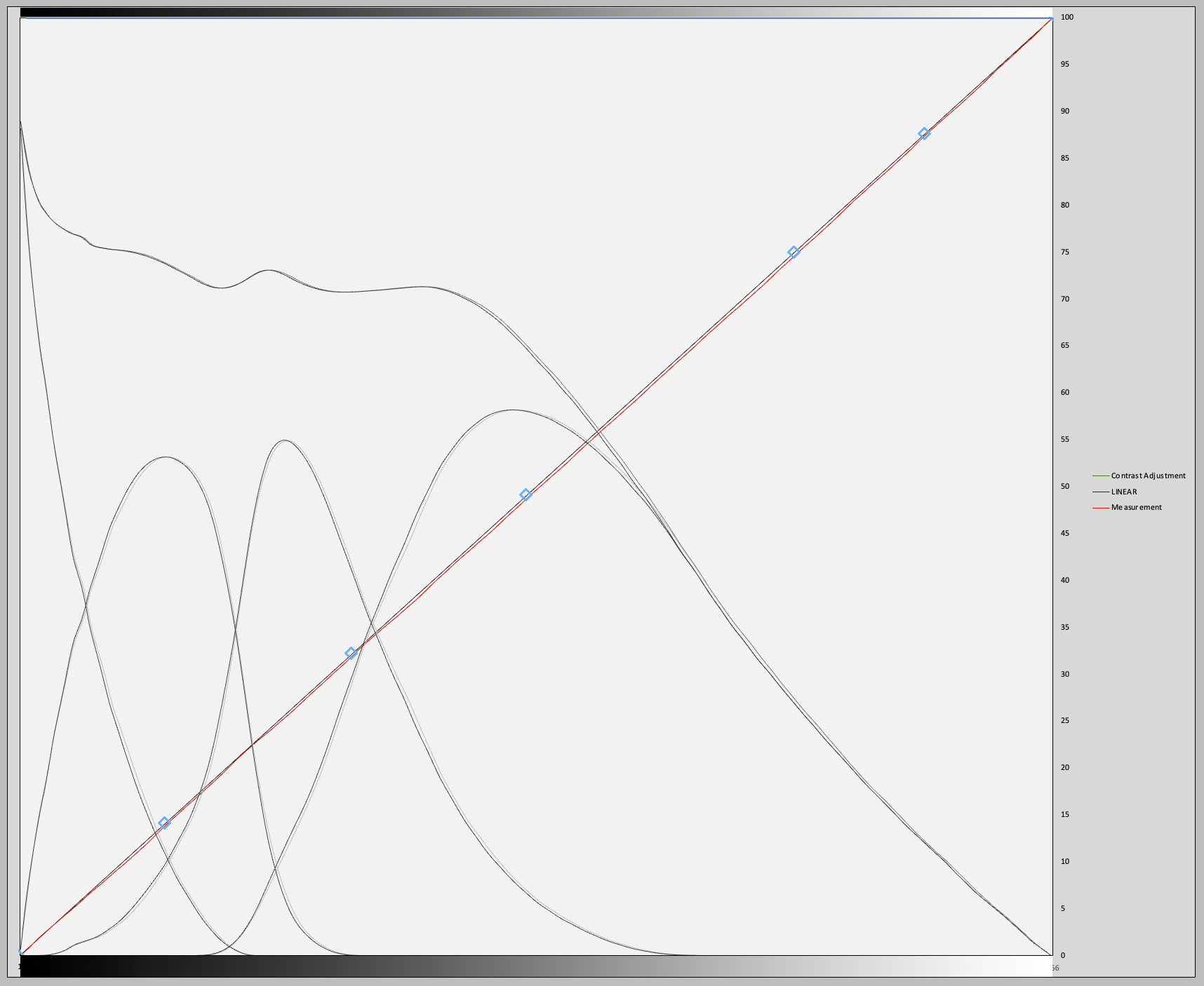

After being away from this for a few months, I thought back through the whole thing and looked at the data. Felt like I was chasing my tail. In the period prior to the problem I was not using the printer much beyond daily printer hygiene (daily nozzle checks and regular cart agitation) and I thought maybe pigment was settling in the line. So, I ran a couple of big purge images that exercise all the channels. Then, went back to the V0 profile. Here is the result of one iteration of linearization.
Boom! And the DMax measures 1.83.
Problem solved.

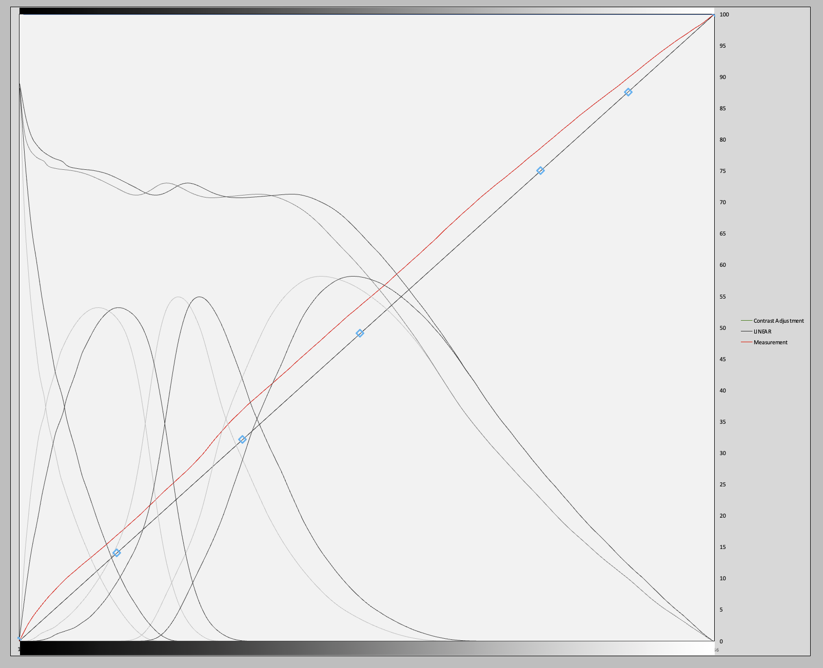

For the nerds in the back of the room, here is what the graph of measurements looks like from V0…
