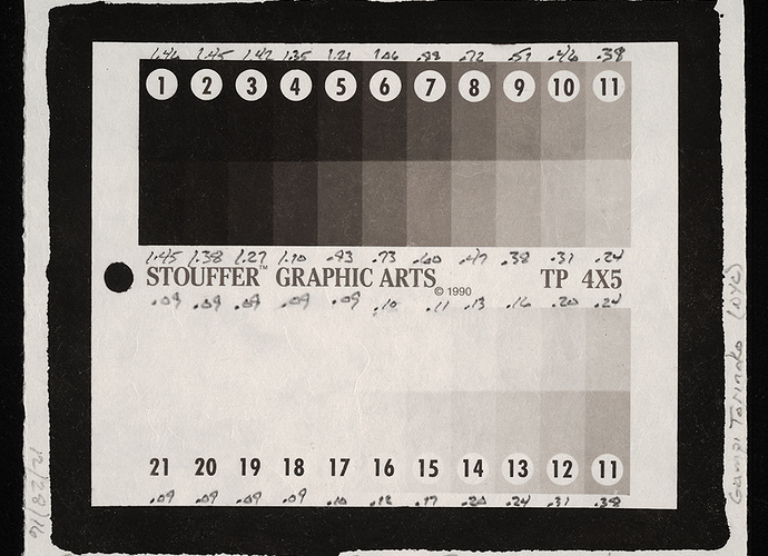

Here’s how I set it up:[attachment file=31248]
This is easy with the 4x5 Stouffer, and gives you a lot of useful information both visual and measurable. The small strip type is less more difficult to interpret.
