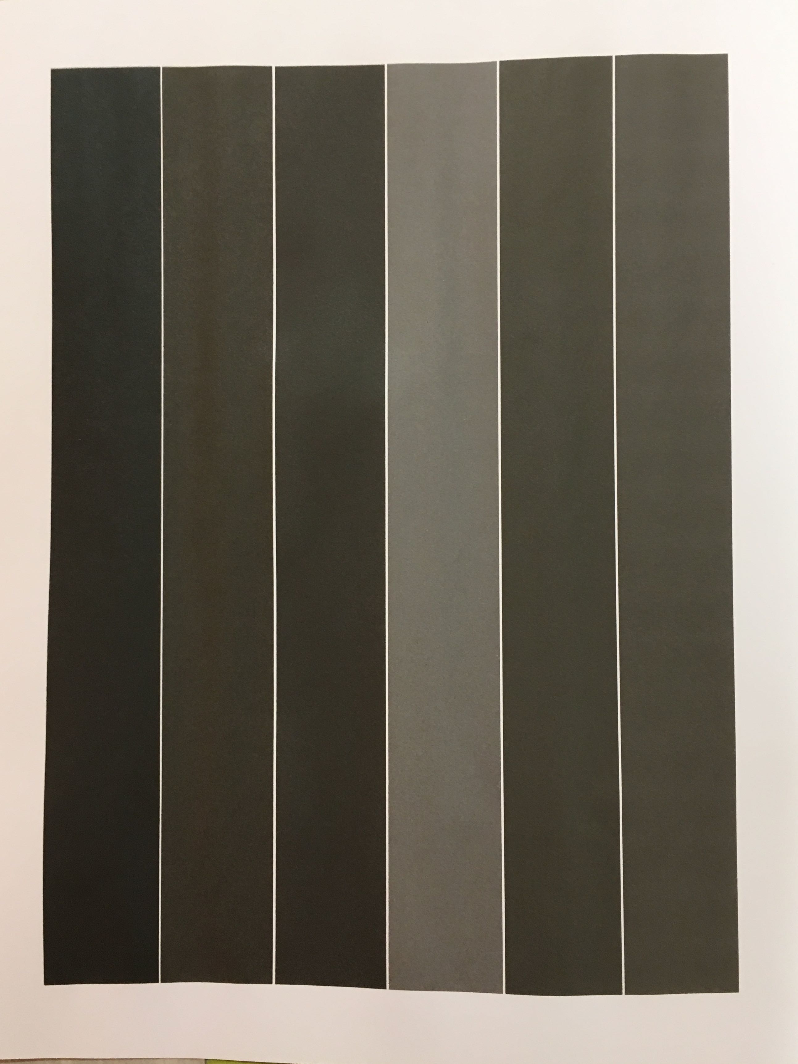

I attach the printout of the 6-channel flush image on regular paper. I will try this on coated paper as soon as it comes in.
The printer was new in January and has been in continuous use, with frequent agitation and several refills. It is conceivable that I neglected to agitate the bottles before filling the syringes; perhaps this has caused the problem. Should I order new ink and start over, perhaps with the new cartridges for the 1430. What do you recommend?

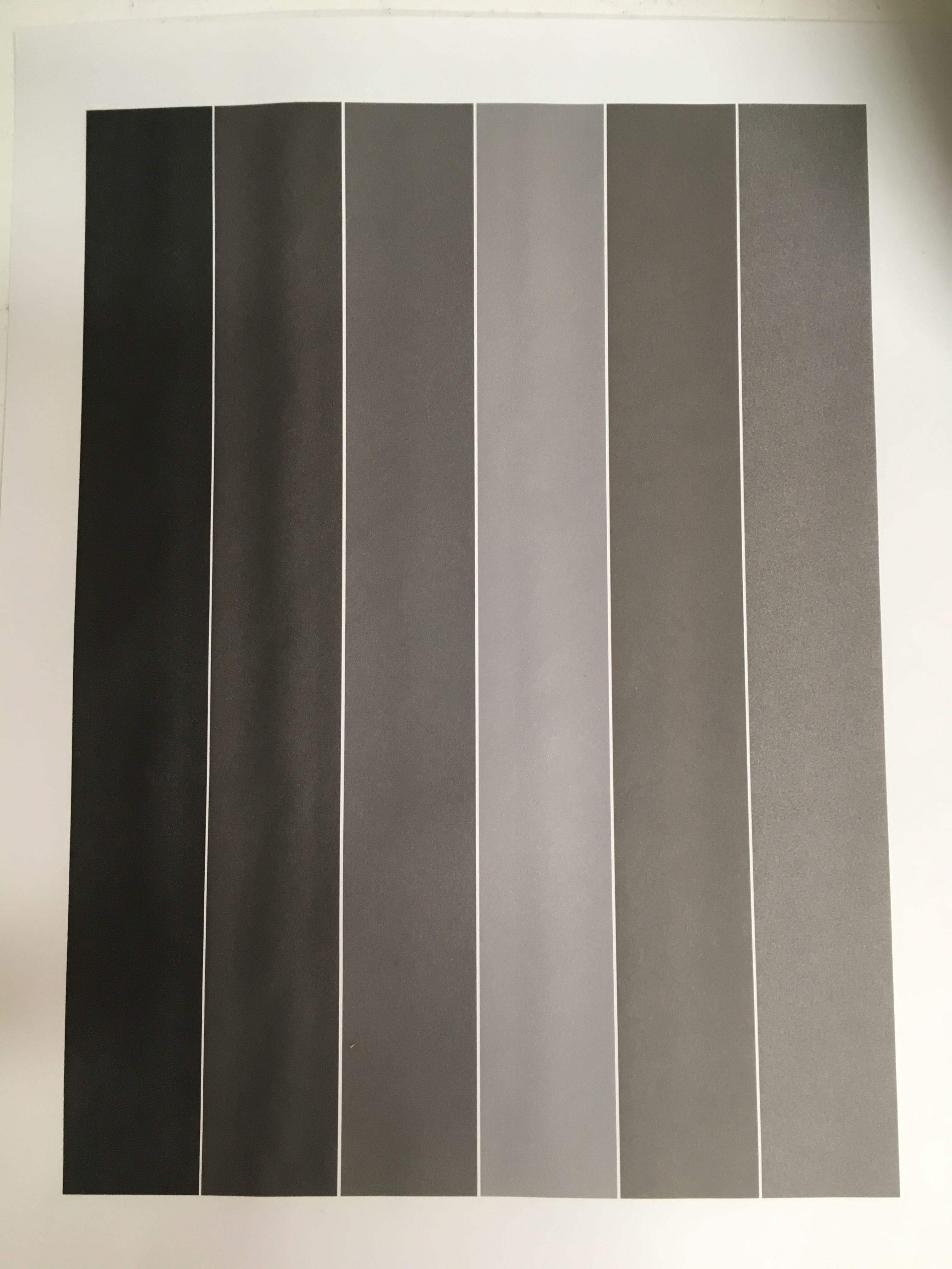

Here is the test on coated paper, as Keith suggested. Not sure what I should be looking for…
I also tried reprinting the limiter target on Pictorico with the Master quad, and am still getting very low ink density, much thinner than the first versions I printed shortly after getting the printer in January.

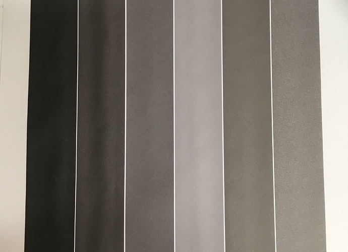

Just a little observation that may or may not be meaningful:
Looking at the purge print (which is shown upside down) the ink positions left to right are K, C, M, Y, LC, and LM which should correspond to ink shades 1, 2, 4, 6, 3, and 5. It could be a trick of lighting in your picture of the print, but it looks like your ink shades go 1, 4, 2, 6, 3, and 5.
I don’t see signs of any lack of ink here (though Walker may see something I’m missing), but is there any chance you have shades 2 and 4 switched? I know this is not likely, but just want to be sure.
One more thought - could your Master quad have gotten corrupted? It may be worth reinstalling PiezoDN and printing one more time just to rule that out.
If I have followed this correctly, the issue is that step 1 is not printing as black as it did initially. Is that correct? You probably don’t have a transmission densitometer to measure the actual densities, but a picture of an older blacker step 1 next to a more recent less black step 1 on a light table might be helpful to see how much difference there is.
One thing about this that confuses me is that my New Cyanotype curve uses no K at all except for step 1, which suggests to me that the influence of a misbehaving K on the rest of the curve should be nil.

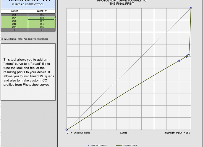

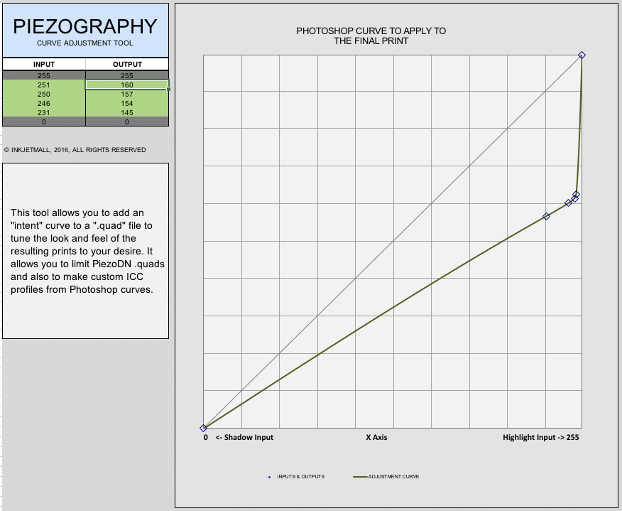

And one more thing - looking at your limit adjustment curve, I see the second point is way too low. In effect you have set the limit at whatever the output number of that point is - it looks like about 130. I would try something more like this: [attachment file=29757]
It may be a combination of all these things that is causing the anemic negatives, especially if step 1 really is lighter than it ought to be.
Thanks, Keith, I will try all of the above. Very helpful hint on the limit adjustment curve, I tried several variants but was unsure how to imitate what’s shown in the manual when the limit number is as low as 160.
