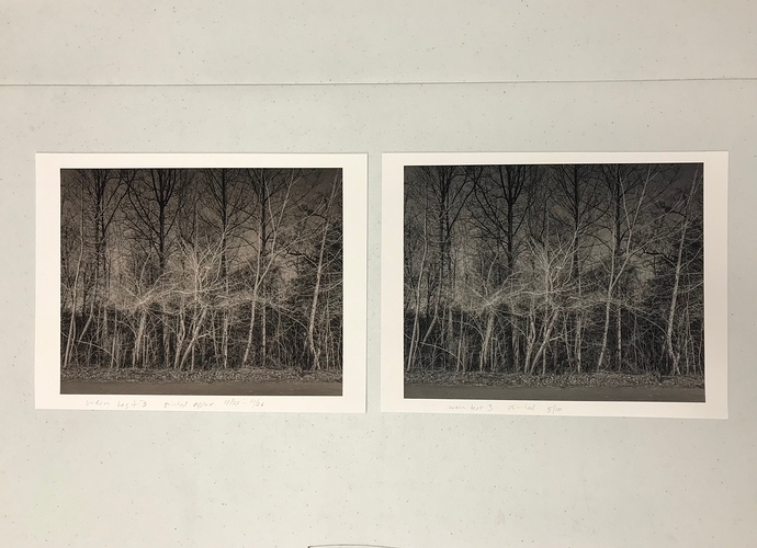

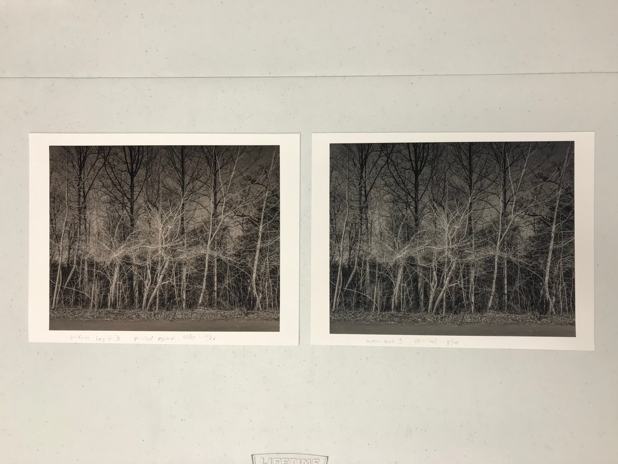

An odd thing seems to be happening with my printing and I’m wondering if anyone else has seen it. I’ve been making some tests with the blender tool and noticed that after about a week or so the prints shift dramatically warmer in color. I’ve attached a picture of a side by side. The one on the right is a fresh print and the one on the left is the same file, same curve, same printer, same paper, same storage conditions, from about 2 weeks ago.
Any thoughts?
Andy

What paper? Matte or Glossy? One thing I discovered back when I started with Piezography Pro is that the inks can take MUCH longer to fully dry compared to OEM inks. My practice is to use a hand-held hair dryer on a new print for about 20-30 seconds after it comes off the printer, then let it lay exposed to air for at least 24-hours before doing any density measurements or trying to judge print color or overall brightness. Humidity level in the air also affects print drying time. Has humidity changed in your storage environment over the last few weeks?
Dave
The paper is Canson Rag Photographique 310. To my knowledge conditions haven’t changed much in my office where the prints are. The strange thing is the print seemed to remain pretty stable for several days. I was away from my office for a long weekend and when I came back I looked at the prints and thought “wow, I don’t remember them being so warm” so I made a fresh one to compare and discovered the shift.
Andy
I haven’t seen a shift like this (such a drastic one) but I have seen it change a bit over a period of 5 or 6 days on CRAG in particular. Something with the titanium white in the paper base I think . . . for example, c-rag has always color-reacted with K7 neutral as well (particularly in the shadows which go blue/cool and settle over a period of about 5 days) . . .

I just realized I had an old 256 step target I printed on 4/17 and measured on 4/18. I measured the same target today. There is definitely a significant shift. I’ve attached the two measurement files for reference. The linearization actually improved, but colors shifted warm.

Wanted to give a little update regarding the color shift I saw in my prints. I’ve been collecting data and, long story short, it appears to be environmental. I took one calibration patch set and put it in a box and brought it offsite. Another identical patch set was printed and left open in my working area. The patch set that was left in my working area shifted much more then the boxed offsite patch set. I’m currently testing to see if it was the lights in my work area (fluorescent office lights) or something in the air. I have the boxed patch set currently in my working area where some air can get to it, but still covered to not allow light. I’ll see how that shifts over time and report back. If anyone wants any data, I’m happy to share. The proof print that was printed later has also visually shifted to match the earlier print.

Walker, my office is unfortunately in a terrible building. I’m in the basement so there are no windows, the HVAC is awful, and we have had a recurring hydrogen sulfide issue from problems with the outside septic lines. Oh the joys of Brooklyn… When you were in Chicago, did you find the color shift only with rag papers or others as well?

I was near the last coal fired power plant in a major city. I had hepa filters inside but if a client left a roll in their car with their windows cracked they would see yellowing of the paper (and sometimes discoloration of the printed part as well) within a week or so. This was with early Hahnemuhle Photo Rag. Canson Rag was changed about 3-4 years ago due to a similar problem (confirmed to me by Philipe who is the R&D guy for Canson). This caused a lack of dMax but more stability in the paper surface related to how it handles sulfur. That said, sulfur is no good for rag surface papers regardless of their rated archival nature. It changes their PH and ink absorbtion.
