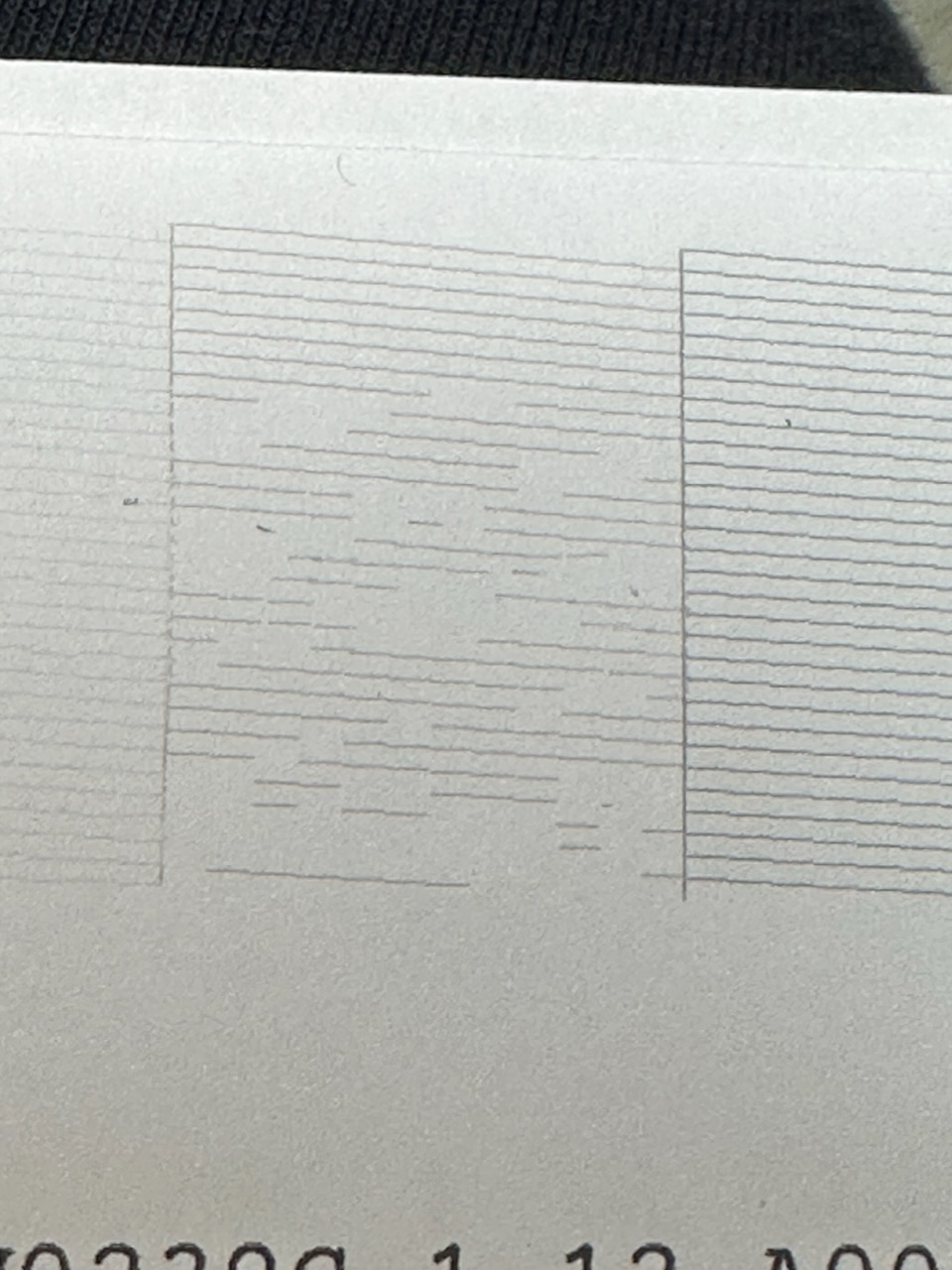

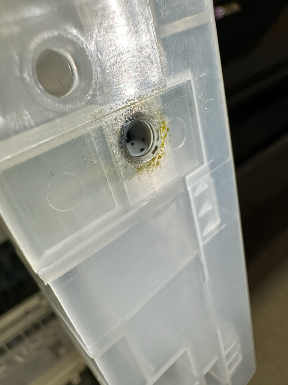

This was the nozzle check when it first started - and varied slightly between cleanings. It got worst, then better again but we just can’t clear the channel. I looked at the yellow cart and the slot that the ink plugs into was crusted with the previous yellow ink - and I wonder if there is a problem with ink flow at the cartridge.

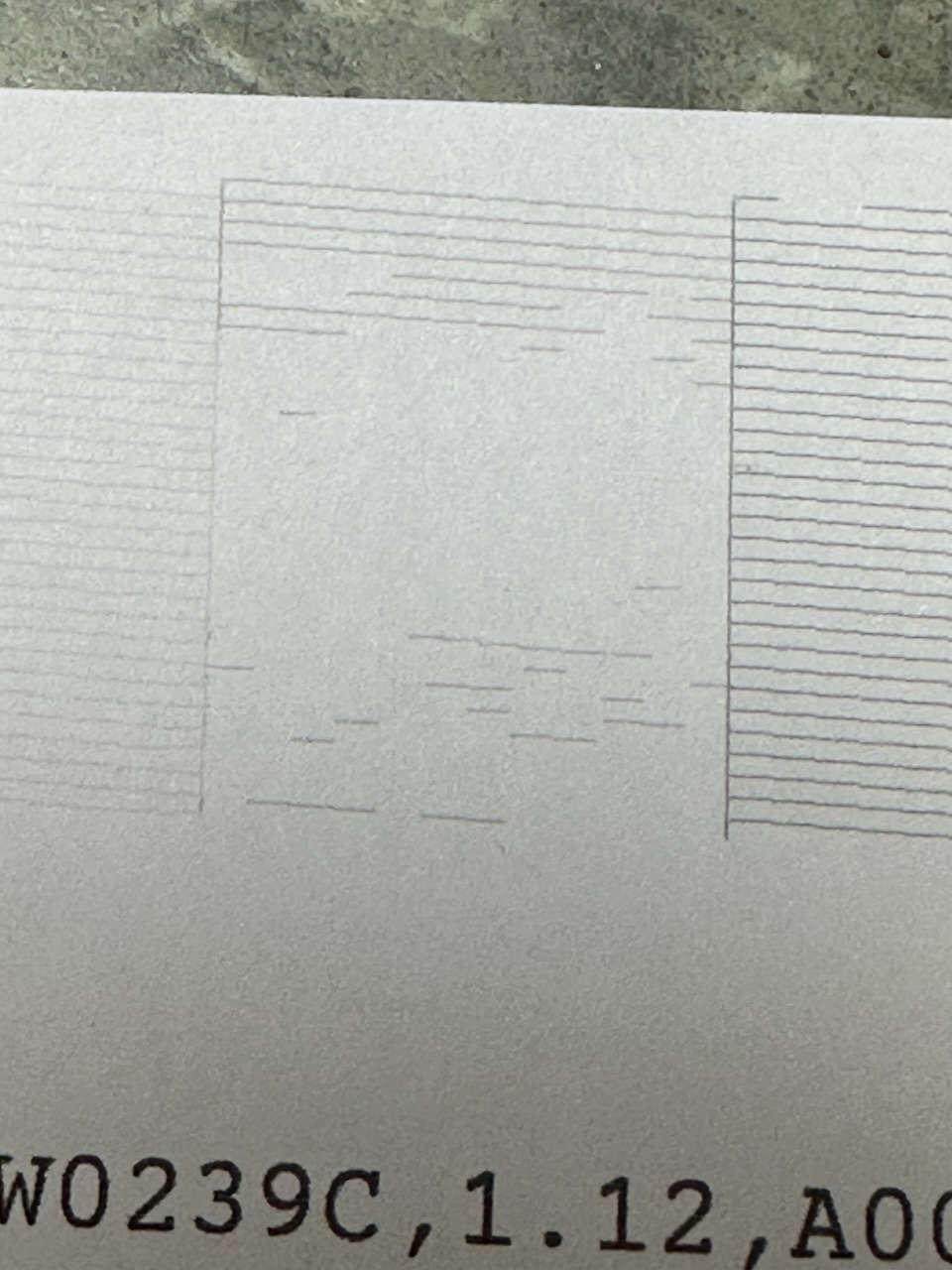

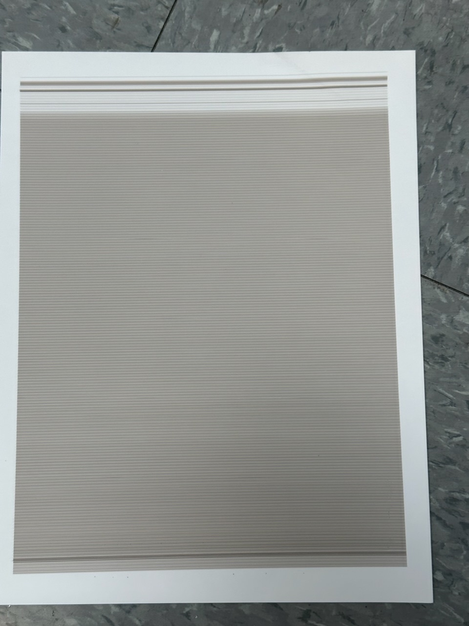

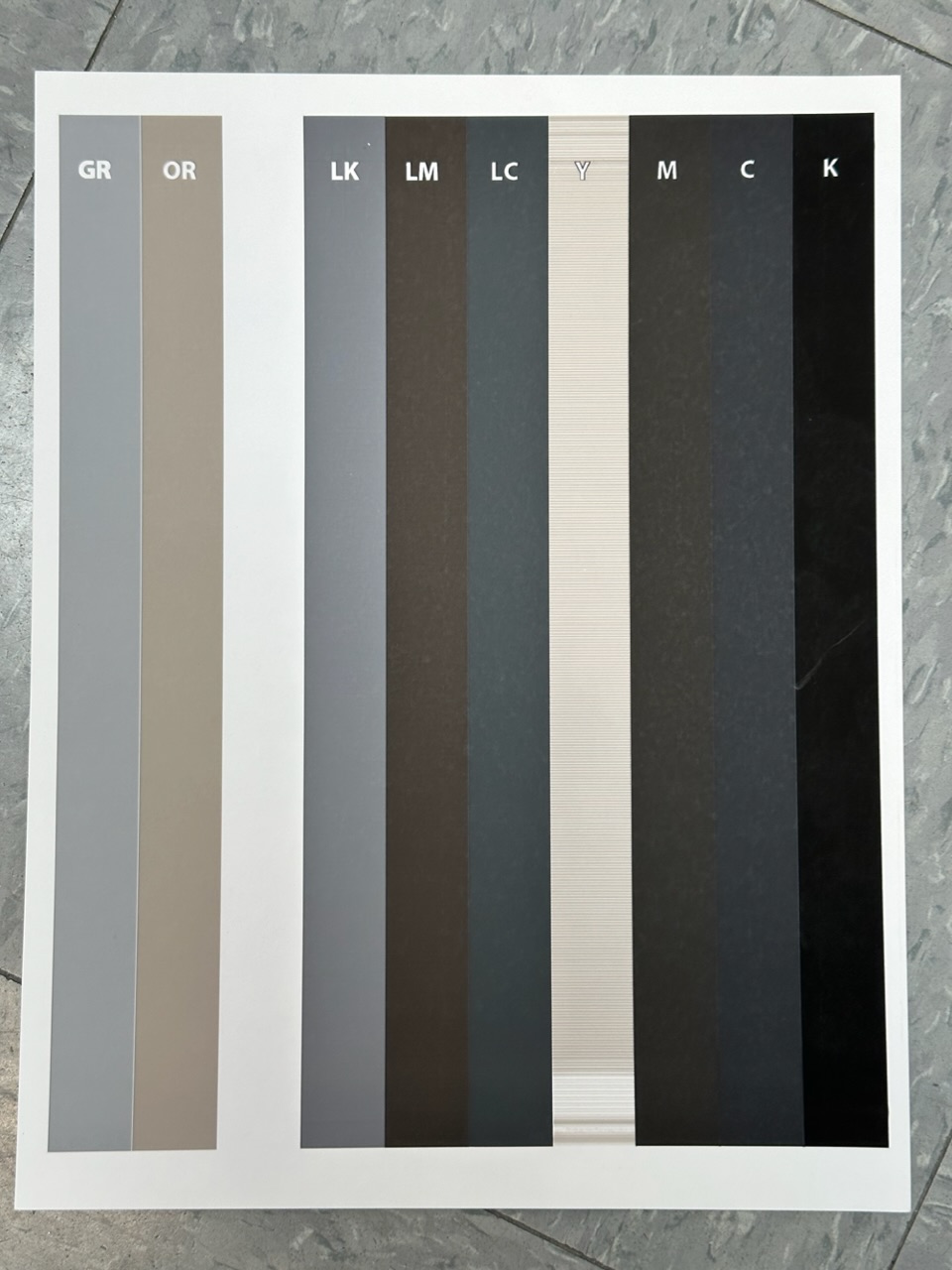

Anyway - here are some photos of nozzle checks and channel purges.

It looks like the beginning of a de-lamination. So it’s not going to be cleanable probably . . .

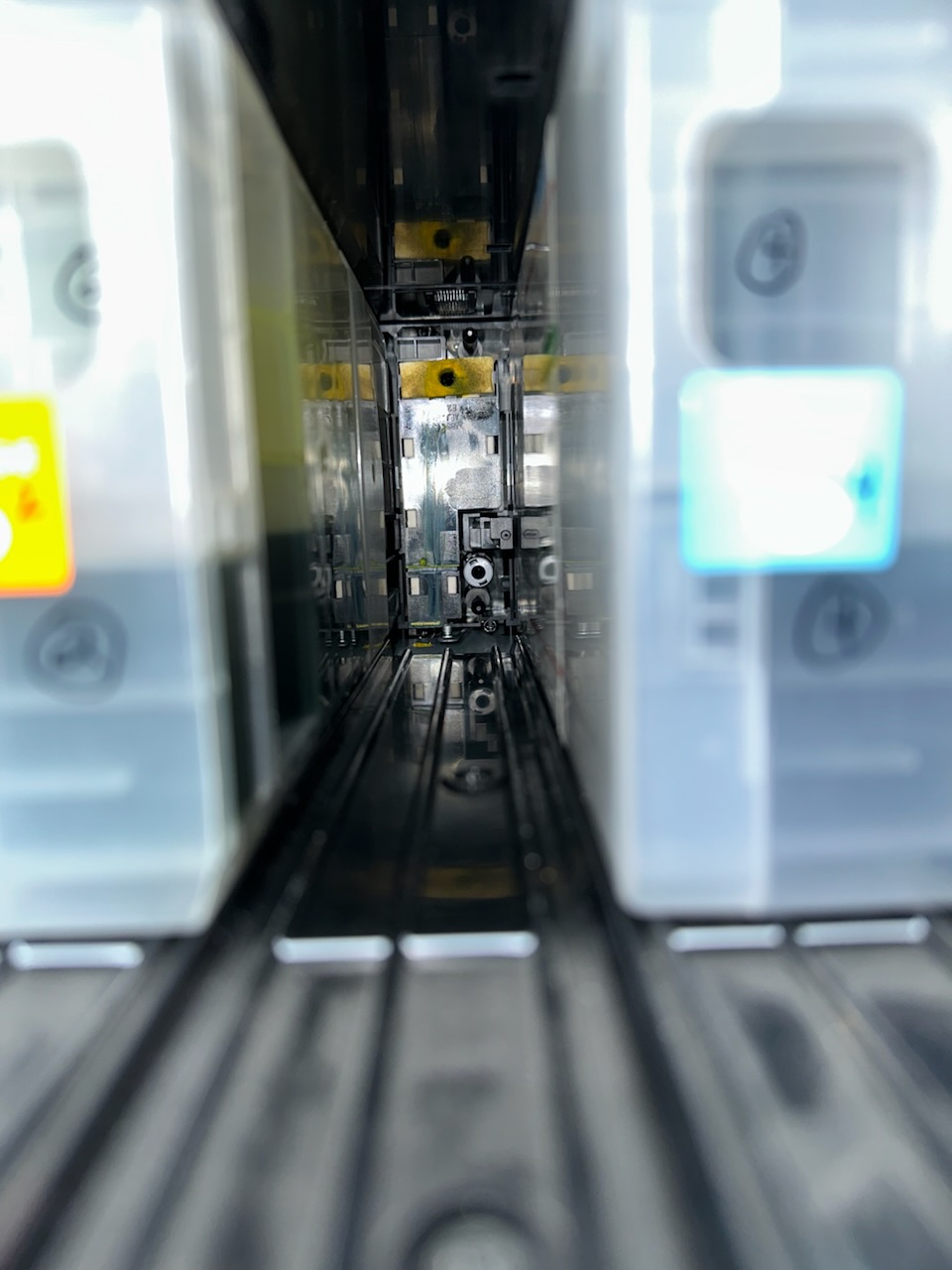

However, the lock tab (silver tongue thing with a lock post sticking up) is too far down. Lift it up a few mm with a flathead screwdriver and it should allow for proper ink flow. But you may need to migrate the Yellow channel to one of the available secondary (alt) channels (Orange/Green).

As for the cartridge, can the “inlet” in the back of the printer be replaced ? All the other cartridges are completely clean while the yellow one accumulates a significant amount of ink around the valve - which is why I thought there might be an ink flow problem.
We’re using Pro K5 and would like to keep it that way in the future but for now we could remap the yellow channel… unless we remap to the GO channel since we hardly ever print gloss (we print 99% MK).
This is what it looks like
1A39 fatal error indicates a blown head fuse (different issue honestly).
Time to not send electrical signals through that channel.
Won’t nozzle checks and cleaning cycles send signals to the yellow channel even when it’s remapped ?
