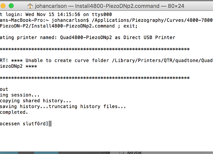

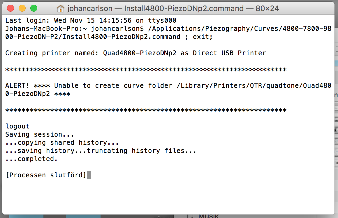

Hi Walker. I have a problem installing Piezo DN P2 curves on 4800 printer.
I get an error message as follows.

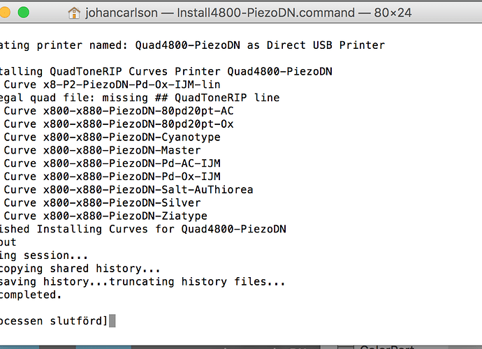

If I try to install Piezo DN - no problems.

I have followed the instructions for uninstalling-reinstalling the printer and turned the print tool off.
Best regards, Johan
              I will try again to attach screen images.
[attachment file=28668]
[attachment file=28669]

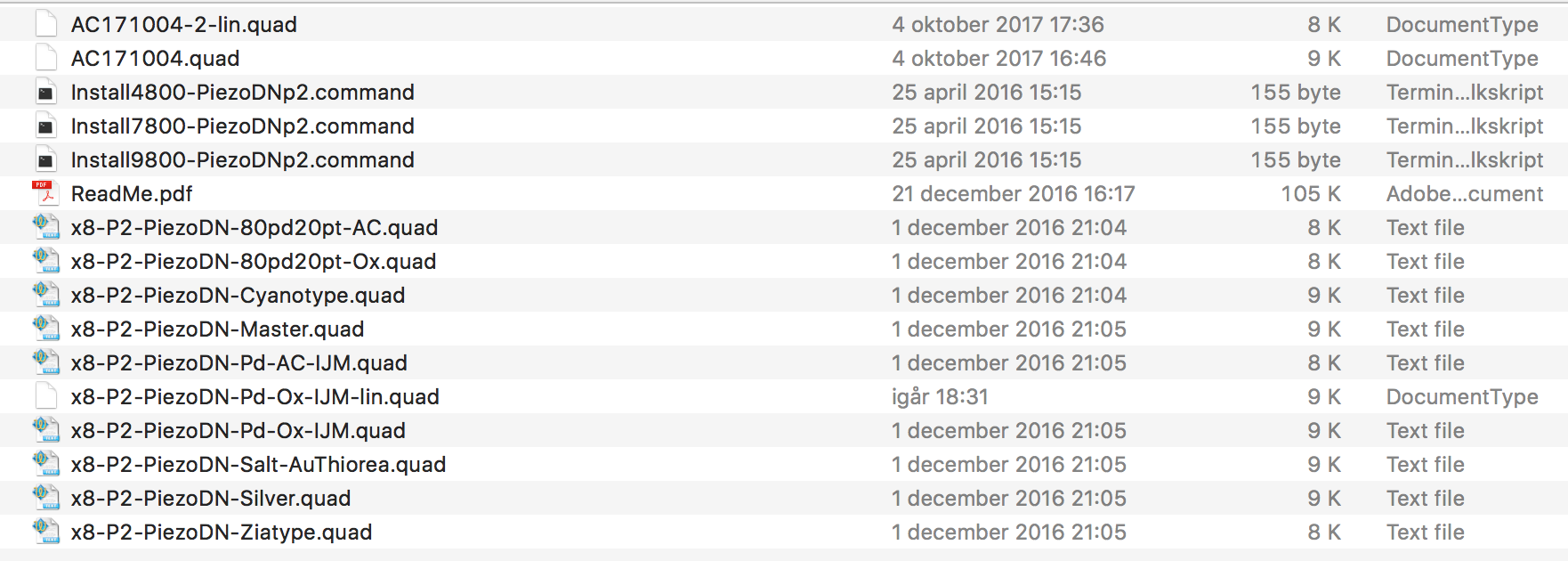

              And content of 4800 file :
[attachment file=28672]
              Re-install quadtoneRIP and try again.
Otherwise, type this command in terminal and try again:
sudo chmod -R 777 /Library/Printers/QTR/quadtone/
              Thanks Walker.
I’m back on track fora little bit longer
