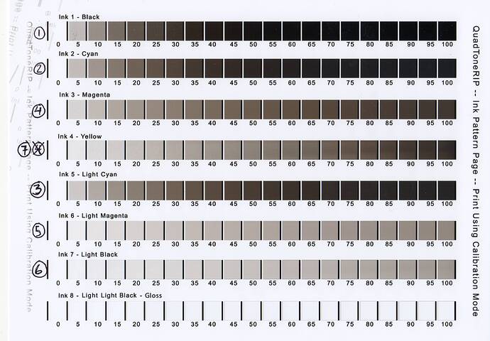

Dear Walker,
I have had some problems with linearizing my digital negative for my carbon printing process. I am using the Cone K7 Carbon inks placed in my Epson 3880 as prescribed. I have also been careful to load my inks in the correct cartridges. However, when I printed out the QuadTone RIP Ink Separation image, my No 7 ink in the Yellow position is not the lightest ink. Both No 5 and No 6 are lighter. I have attached a scan of my ink separation print. In the left margin I have shown my ink cartridge positions circled. Could there be some mix up?
John P
Looks to me like you’ve filled Yellow with the wrong ink, however the yellow channel is not used at all with Piezography Dig Neg printing so that should not effect it
