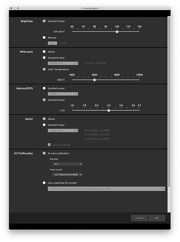

Please can you point me in the right direction for creating icc profiles and calibrating my eizo for use in a piezo pro calibrated system?
Thank you in advance.
Eizo calibration should be:
6000k
100 luminance
1:200 contrast ration
ICC profiling of Piezo is another ball-game. If you have a well linearized system ( you do with pro) you can simply output with the Piezography Matte Print or Piezography Gloss Print ICCs for a good screen-to-print match without having to soft-proof in photoshop.
Thanks Walker
Again, will try it out today and revert back if there are more queries.
Have set to 6000K, 100 luminance, however, no option to set to 1:200 contrast ratio.
The Gamma is set to 2.2 and increasing it gives me more contrast, and the opposite for reducing it. Any recommendation on that?
TIA
set you black point up a bit and calibrate. it will give you your contrast ratio post calibration. Then do it again with a different BP if it’s not 1:200
Keep 2.2. It’s not a factor in contrast exactly . . .
