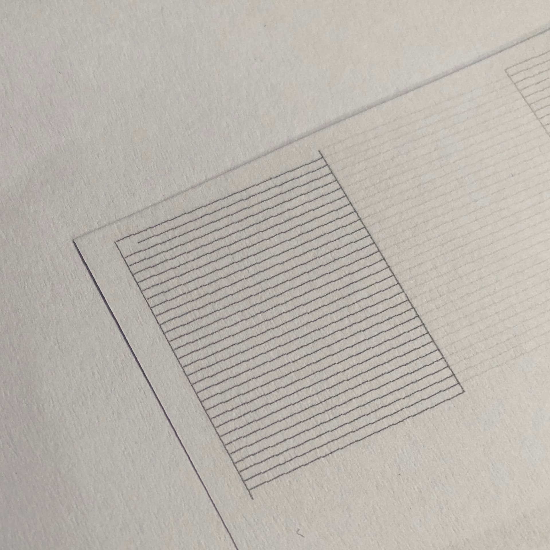

Hey @walker
Got one blocked nozzle in the Cyan channel on my 9900 - just the one bar. Tried pair cleaning, power pair cleaning and service mode pair level 1 cleaning (the gentle one) - it’s not shifting.
ETA: Tried printing QTR-C-flush.tif and the bar is still missing, image below (same channel, just upside down):
Any suggestions? What effect will this have on printing?
TIA
I replied via email I think, but this is indicative of not a de-lamination but a head that has dried crud on it. You need to do the following:
_Walker
Thanks Walker, will get to it :slightly_smiling_face:
Worked a treat @PiezographySupport, thank you again.

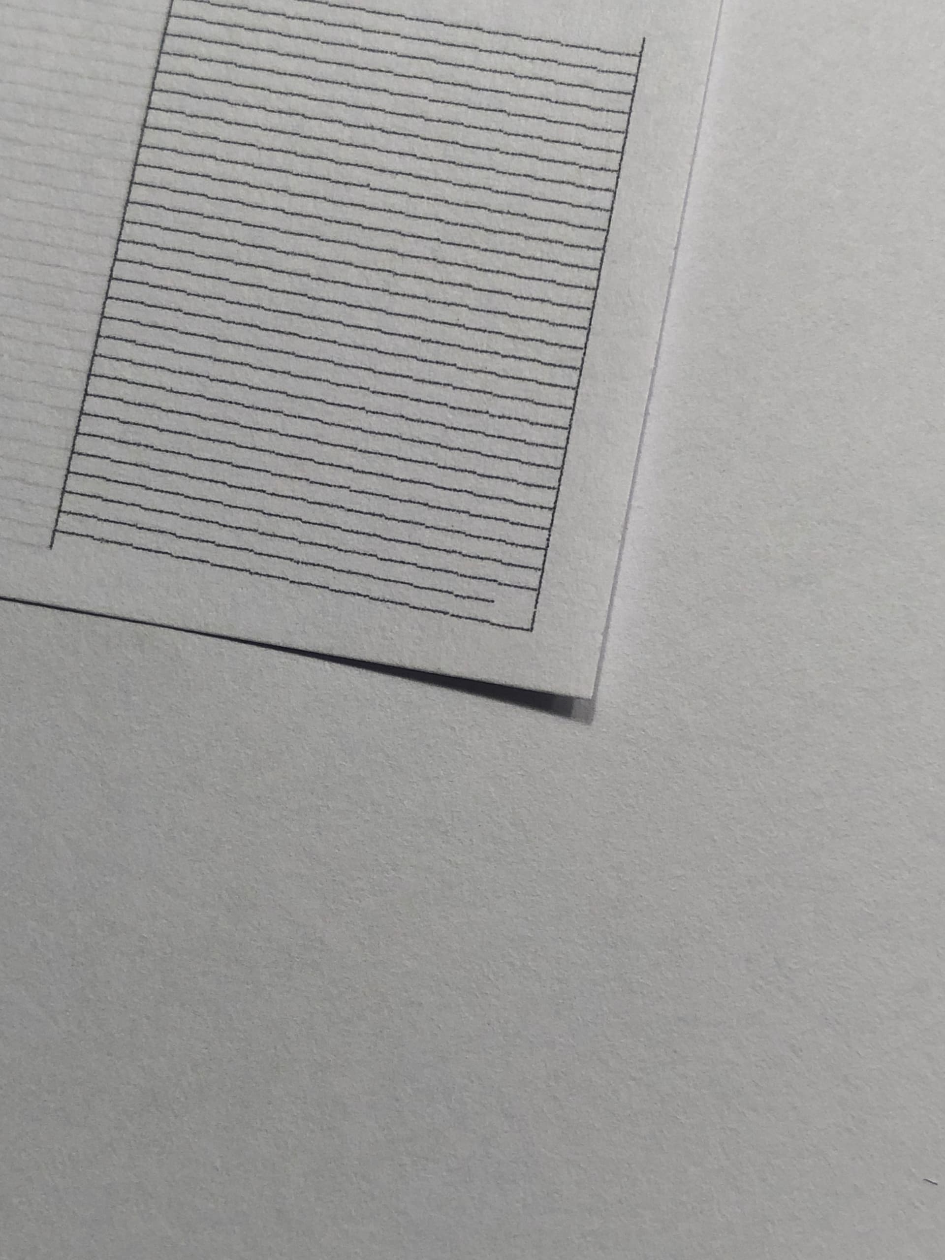

Hi Walker. - I’m having a similar issue with my 9900 where a single bar is missing in the PK channel. I’ve tried everything described above and the clog persists. Is leaving the print head parked over the piezoflush-soaked paper towel for a few minutes to soften the gunk a horrible idea? A fair amount of ink came off of the print head using the “shoeshine” method, but this one little bar seems especially stubborn.
Or if you have any other ideas I would appreciate hearing them.
Thanks, as always.
cjh
Dear CJH, this is most likely not a clog but is a de-lamination of the head.
sorry for your loss
