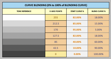

I’m back to playing with the blender tool, and as a way of teaching myself how to use it I’m trying to mimic the PiezoSE inks on my Pro printer. How does this recipe look for a slightly cool matte paper I’m testing on?
Thanks.
-Mike
yep, that’s just about it!

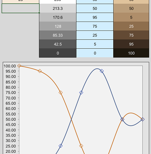

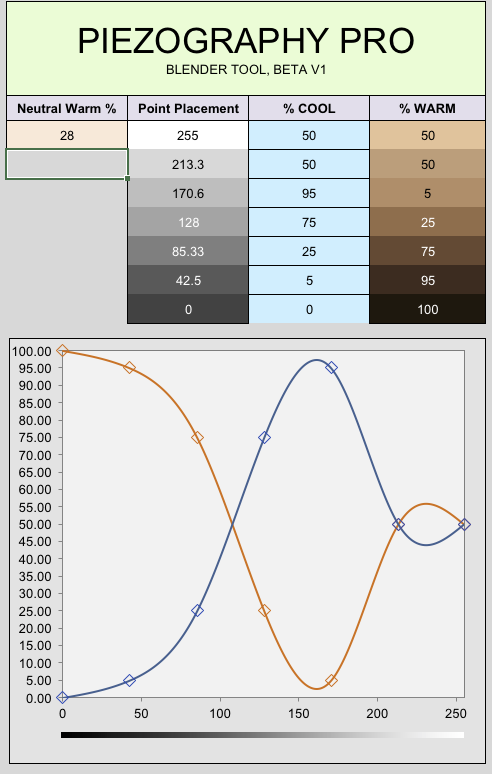

Special Edition has always been a favorite of mine in the K7 ink lineup. For a while now I have wanted to re-create it in Pro but only recently got around to playing with it. Using the above as a stepping-off point, here is my latest iteration using the Blender tool in PPE2 on PhotoRag.
Thank you for sharing the blends above, Special Edition K7 was a favorite here too. Forgive the naive question, but how would you translate these values to three sliders in QTR Print Tool for Pro inks?
Hi @sperry. I’m not sure how those would translate to the sliders in QTR Print Tool. In my earlier testing, I found the transitions were more to my liking when I did the blend in the PPE2 worksheet.
