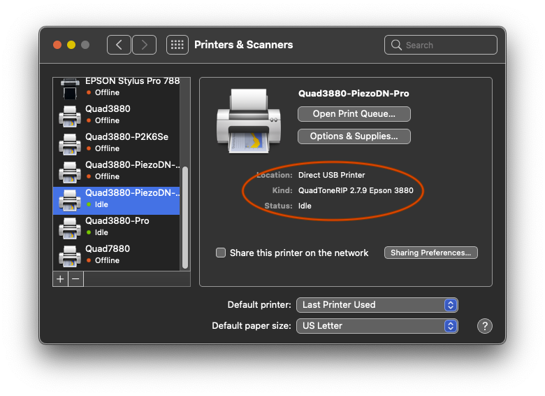

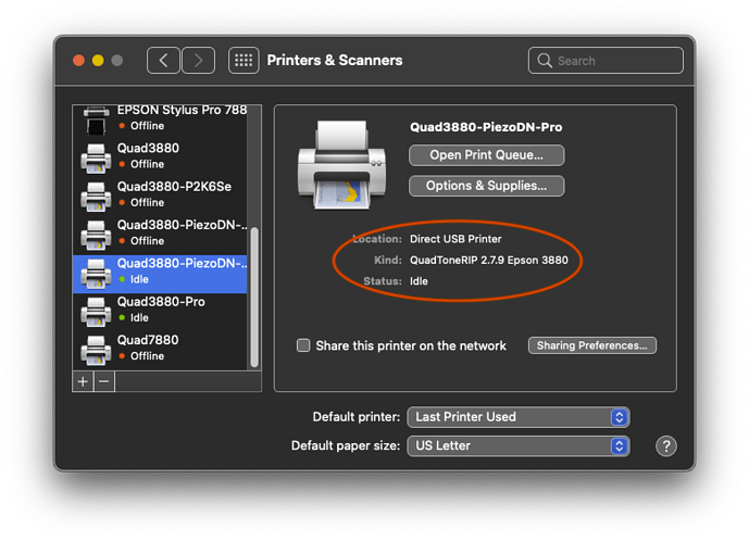

PS – Reverting from QTR 2.8 to 2.7.9 (or maybe it’s 2.7.10, I can’t remember) solved the filter failed thing for me too.
Just wanted to clarify. Were you able to run QTR 2.7.10 on MacOS 11.6 (Big Sur)?
Yes, but to be clear as possible, there are 2 kinds of “filter failed” that I have encountered: the more serious one in which it interferes with printing, and the nuisance one where printing works normally but the message still shows up in the printer queue (or completed jobs list?). I am talking about the latter being solved by reverting from QTR 2.8.0 to 2.7.9. I should note that I am using a 2013 MacPro running on Big Sur 11.6 at this point.
