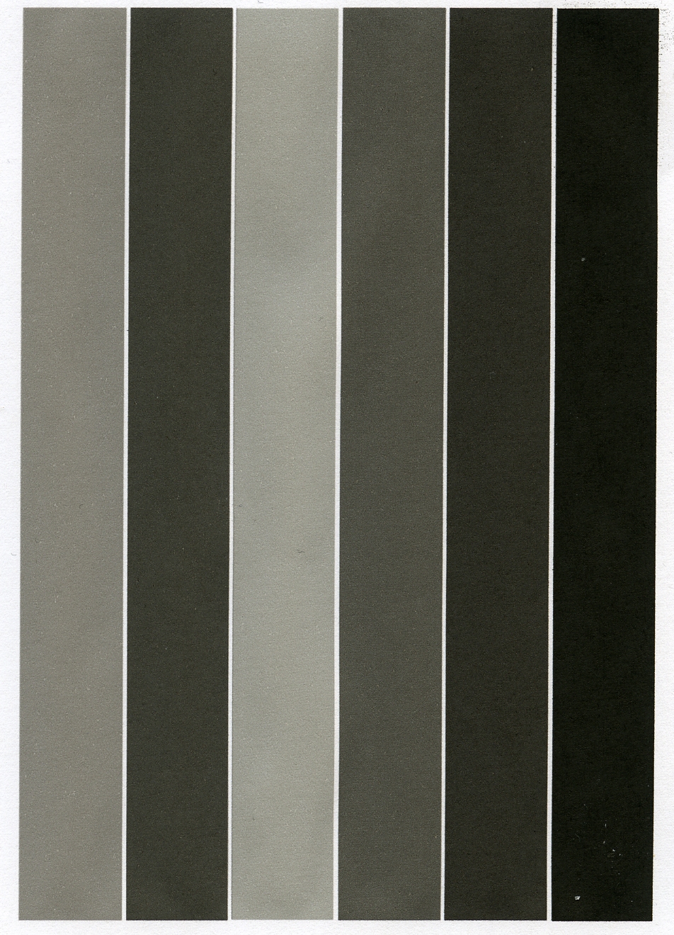

Ok Keith, I understand that printers run into mechanical problems and feel your pain. Sounds like you’re had your fair share of bad experiences. Nevertheless this is a brand new machine with freshly installed inks. I can print a nozzle check without gaps and yet the thing is still banding. So far I’ve had no explanation or suggestions here, apart from environmental factors which I’ve ruled out.
The only real suggestions are off Sandy King who said that QTR has more resolution but isn’t as smooth as the Epson driver and that these differences are more pronounced on smaller models like the 1500W
Apart from that he suggested misfiring nozzles (can’t be, no gaps in nozzle check) or head misalignment.

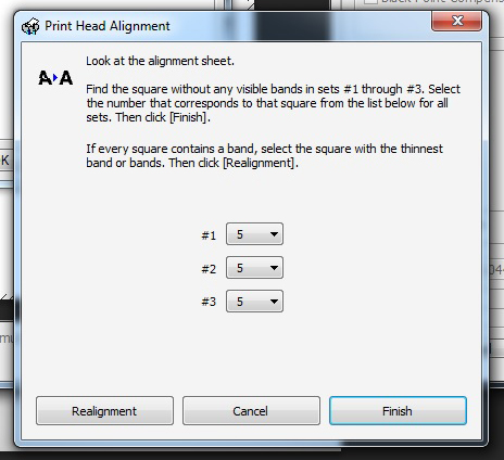

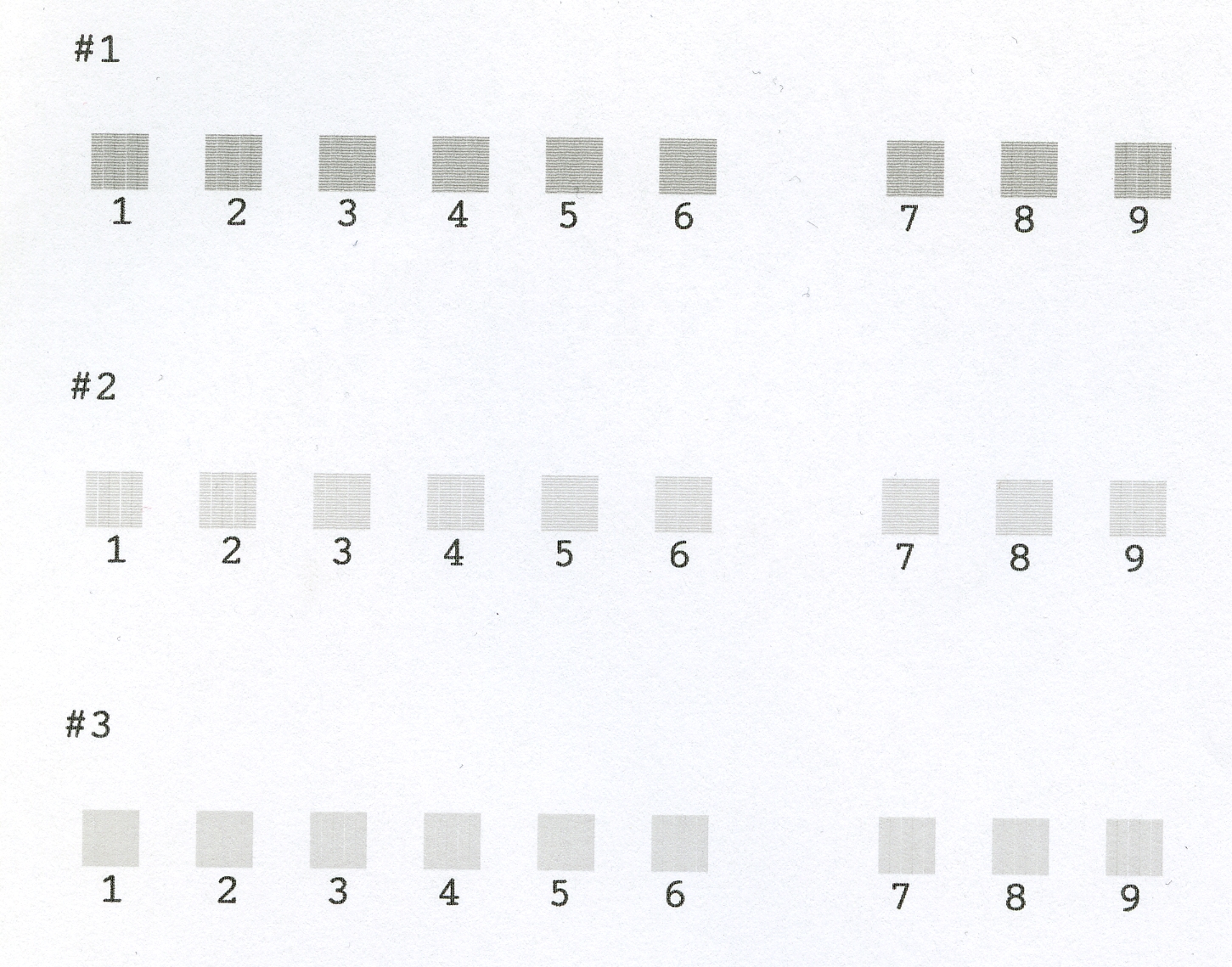

Are you familiar with the process of realigning the heads for this model? I will post a scan of my alignment
below.

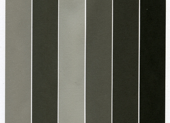

I was able to get smooth negatives with OEM inks on my old R2880, yet on the very same printer the WN piezo inks were inconsistent and banding. I showed evidence in this thread.
I thought the problem was the printer but the exact same thing is happening with a new unused machine.
Could buy a larger model printer, which MIGHT solve the banding at more wasted time and expense. Then arises the problem of ink settling and having to ramp up production.
I should have just stuck with OEM and worked out how to make better process adjustment curves. Have sunk so much time and effort into this with less than exceptional results. Pointless having a perfectly calibrated neg that looks like a pair of blinds.
Thanks Jon, I hope you are seeing something on it cause it looks alright to me

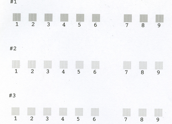

Here’s what I’m seeing related to print head alignment. The scan is how it looks prior to selecting the three dropdown boxes.
As you can see there are boxes that look better but none look that are solid in two of the rows.

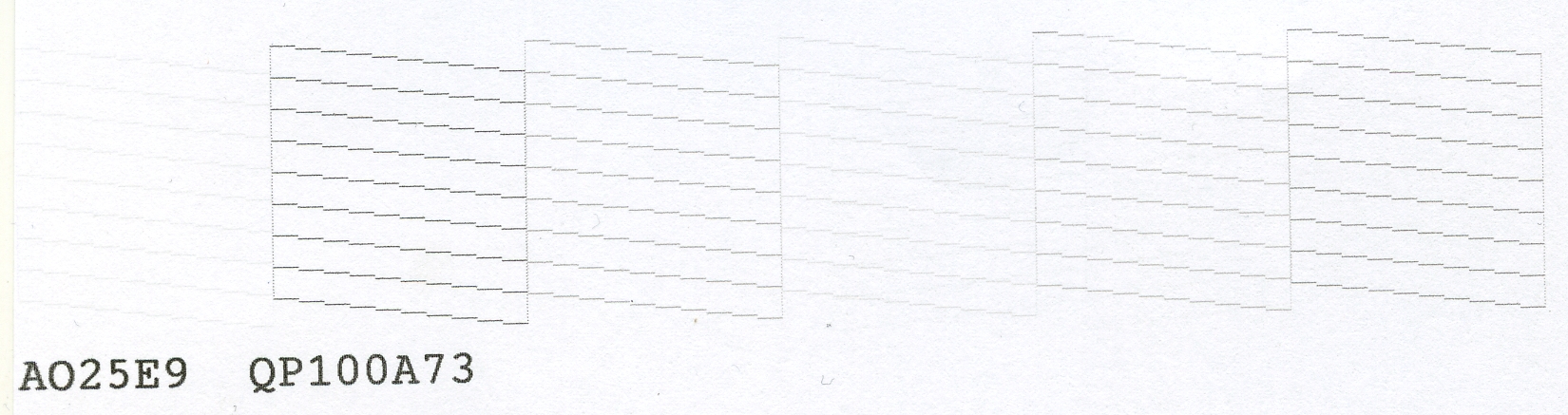

Here is how my 8-channel flush looks. Is this right?

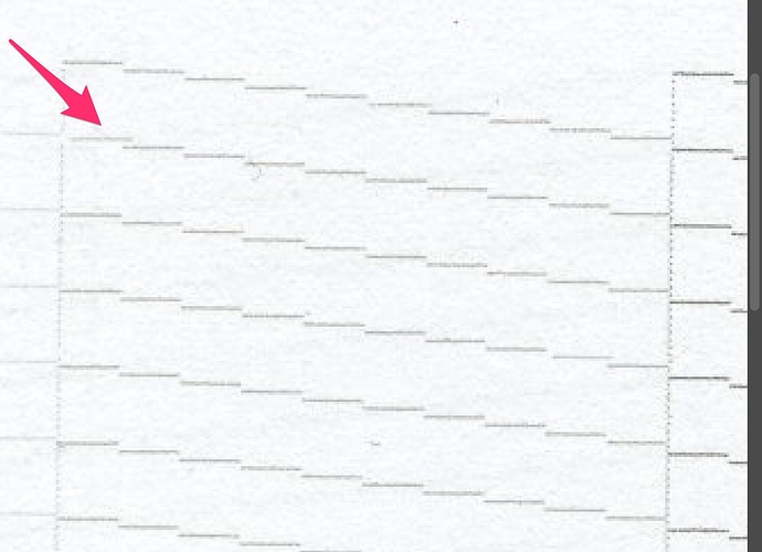

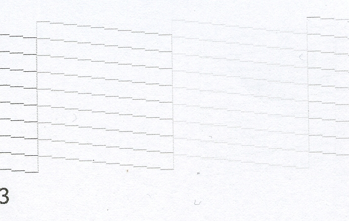

[attachment file=26060]

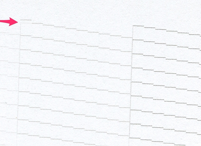

that is a deflecting nozzle printing a level above where it should be with some amount of droplets overprinting the level preceding it. It’s only one but deflection can create havoc and as it wasn’t on your first nozzle check - there is some possibility that you have more than one deflecting nozzle during negative printing.

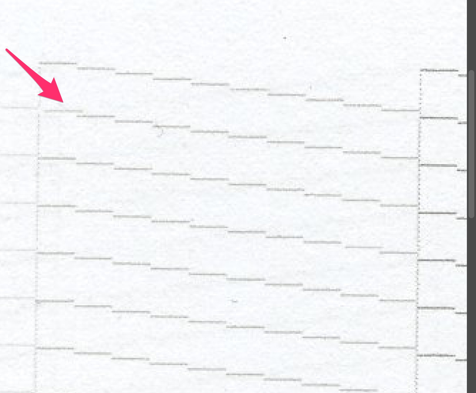

on the one below from your previous nozzle check I noticed besides the gap you pointed out that this same area had an odd overlapping nozzle.
[attachment file=26061]
so this is occurring on the nozzle check and its unknown what is happening with these 3 nozzles during printing of a neg or if there are others as well deflecting and overlapping.
Bad ink (or old ink) would cause this over the entire channel. That can happen with outdated inks. When intermittent nozzles or very specific nozzles are overlapping or deflecting this usually points to a dirty head but can also point to electronics. And yes these are serious enough to cause banding in Piezography.

  5. Alignment could be an issue. I did an alignment on one of my printers a few months ago (but I don’t remember which one, probably the 3880) on Pictorico film. Ideally, a critical alignment should be done on the same material you will be printing on. I found it damn hard, but not impossible, to read the alignment pattern on film!

I’m finding it difficult to read the alignment pattern on paper so it’ll be fun to try on OHP film. Alignment could be a cause of the problem.

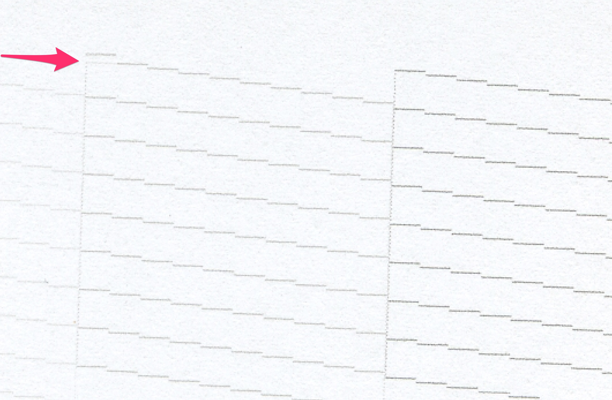

Here is my latest nozzle check after cleaning the underside of the head with paper towel as outlined, then pritning an 8 channel flush and two head cleans.
That NC is obvious still.
