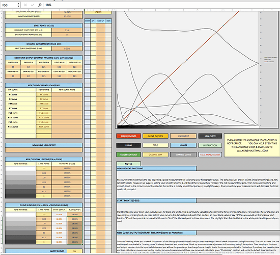

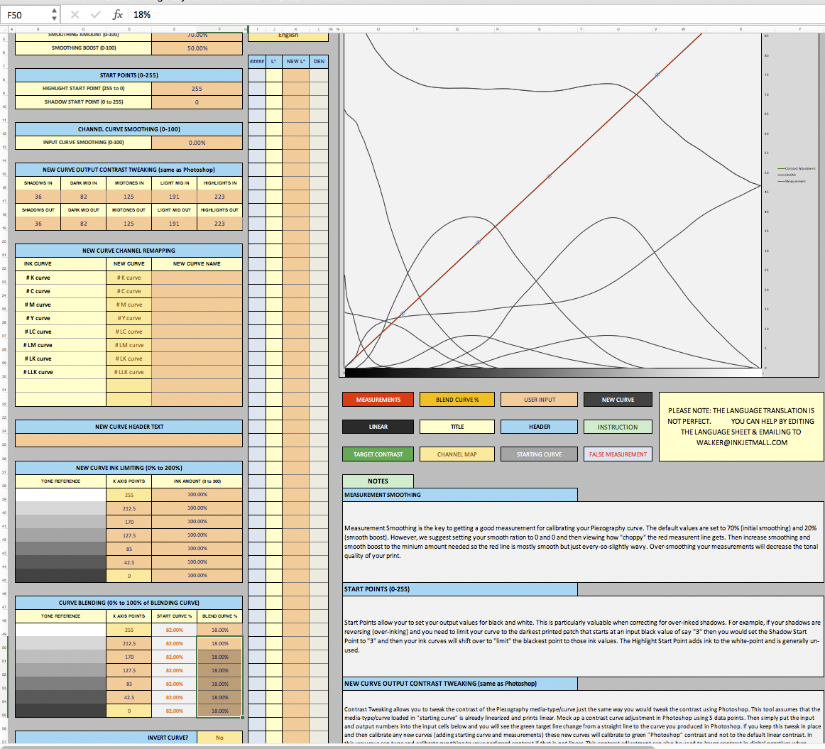

Please show a screenshot your tool with the blending setup if you would.
this is with Cool curve into ‘Starting’ and warm curve into ‘Blending’
There is nothing in there that should create an issue.

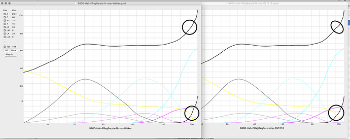

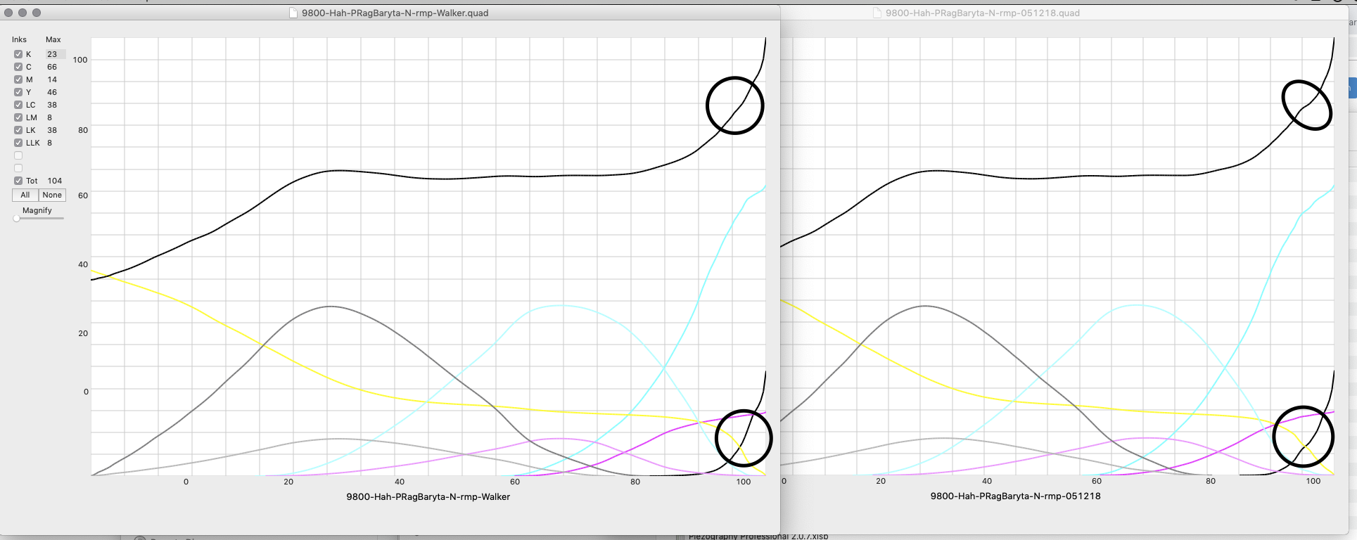

I did an 18% blend of C and W (from your upload) and I get something different.
9800-Hah-PRagBaryta-N-rmp-Walker.quad (8.6 KB)
Thanks Walker
That would seem to indicate operator error on my part. That was certainly my assumption to start with. So before posting I carefully did it again (the blending) and still got the same issue. I also got the same issue when blending the same cures in QTR. But I will go back and look at it again, I will try your version and see, thanks again for your time
Neil
Make sure to run the install command each time. I also suggest to make a new curve name for each try. This way you know 100% for sure that you are using the new curve.
