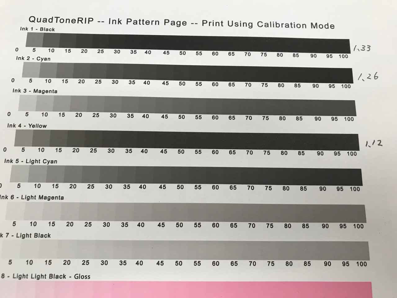

After exchanging the ink, I printed 5 sheets of A4 in the calibration mode using QTR-Y-flush_tif. Then I performed power cleaning three times. After that, QTR - 8 Channel flush_tif was printed out in the calibration mode to check the ink out.
I think the D max of the Y channel is low, but is this normal?
Ink - 1 is a normal PK ink.
You write “the vent plug is out when printing / cleaning”, but what is a vent plug? Do you mean the hole at the top of the cartridge?
This looks like a matte paper you are printing on (correct?). But you have Photo Black ink in slot K and HD-PK in slot Y. Doing a reflective reading of photo black on matte paper tells one nothing about the actual light blocking ability of the ink.
