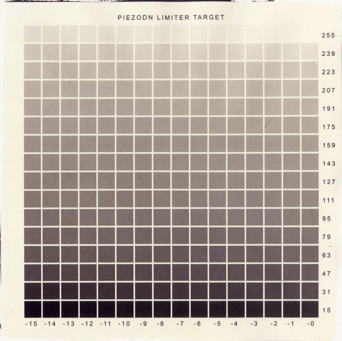

Had to add to this post. Using the 1430-PiezoDN_PD-Ox-IJM.quad curve on a 1430 loaded with sel. K6 set and following the conditions specified for this curve as close as I could. Main difference being I substituted LegionRevere paper instead of the Berger. I have to say I didn’t get past the Using a pre-calibrated quad. as the very 1st attempt yielded a print output closely matching the limiter file with the accompanying LegionRevere soft proof icc profile. Posted scanned Palladium output visually shows step 254 clear separation compared to step 255. Scan is not quite as clear as actual print. Pretty impressive out of the box. Looking forward for 9880 curves to be released for larger DN. Like to see a silver curve in particular. Your effort makes this system too easy.
