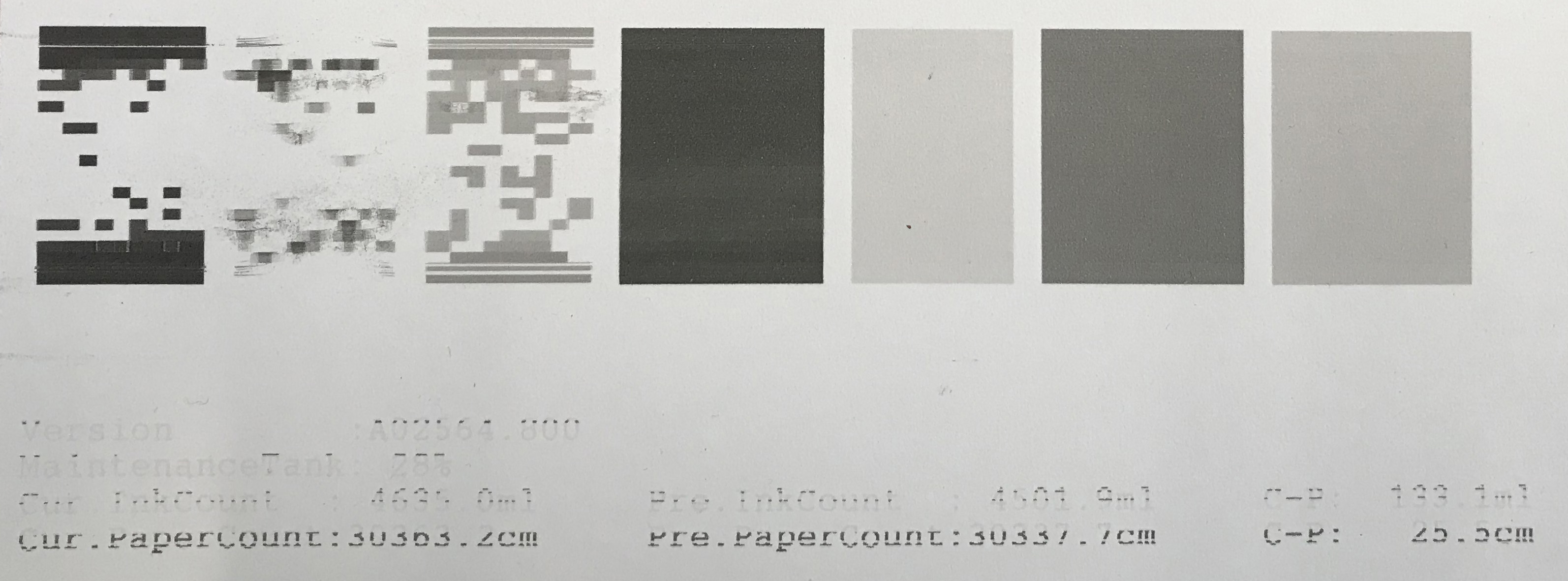

At that point I started to notice that the first ¼ inch and last ¼ inch of a print had some stripes if this part was midtones.
So I did a nozzle check with cleaning and noticed just a few blocks missing at the KCMY side.
I let the head soak on a lint free cloth with piezoflush overnight and did another nozzle check only to see that the problem had gotten worse.
Now there were a lot of blocks missing:

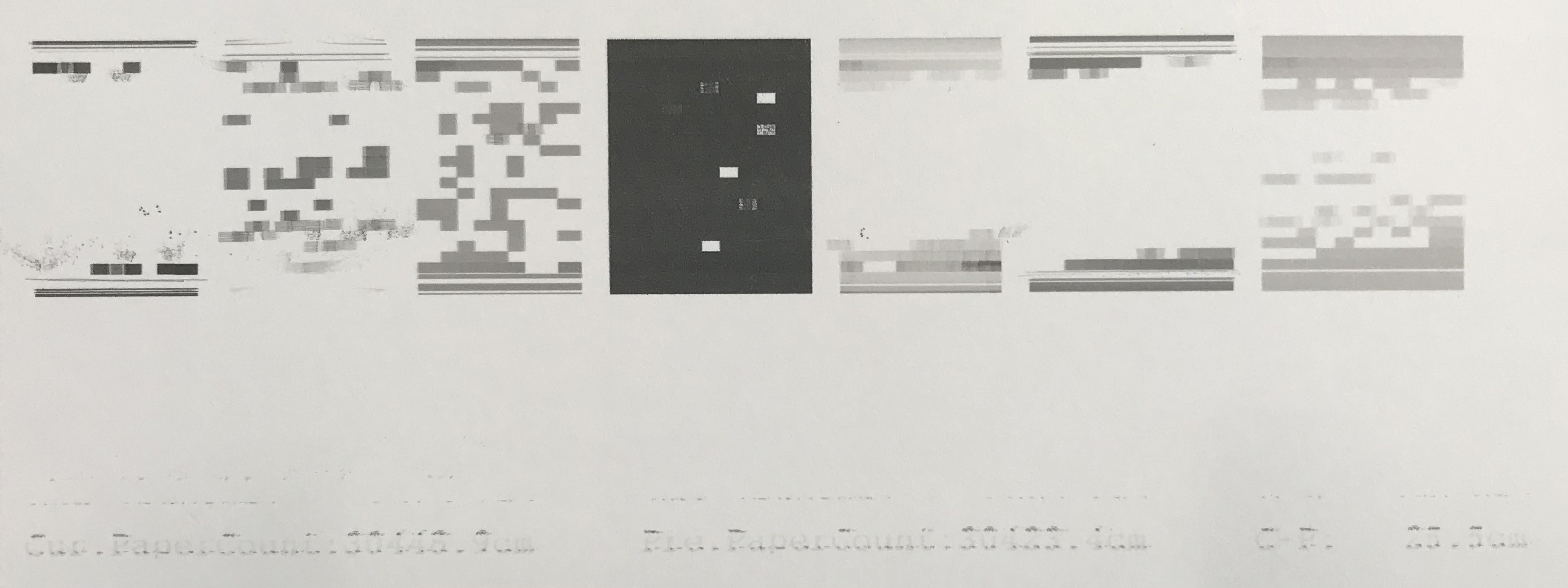

The cartridge arrived this week, I transfered the ink and did two power cleanings from the printer maintenance menu.
It got even worse:

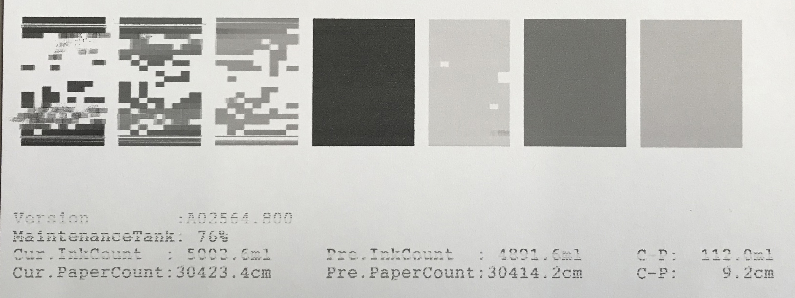

I thought that there could be air in the lines, so I just went ahead with an initial fill, to be sure that all lines were filled with ink.
To my big surprise and shock, this messed up everything:
