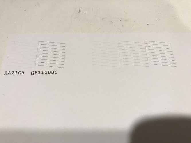

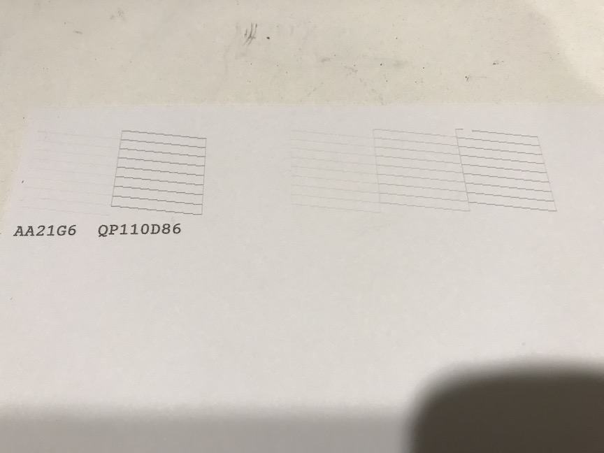

After doing a head clean and then printing a test page, I get this:
You can see that the third head from the left doesn’t show anything.
Am I correct in assuming that the printer head has failed?
What print colour would the third nozzle be on a 1430?
Many thanks for any suggestions/help.
David
I believe the is the light cyan channel
I suggest this:
Thanks, Walker - yes - I did use PiezoFlush and followed the cleaning instructions on your site - to no avail. It’s strange that it just stopped working - the printer was used regularly (but not excessively) to keep the nozzles working. I’ll have a closer look at the cyan nozzle and poke around some more.
