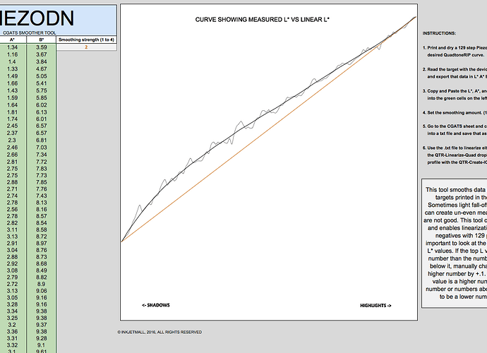

I have attached the smoothed data and a screenshot.[attachment file=29149]
Smoothed.txt (4.4 KB)

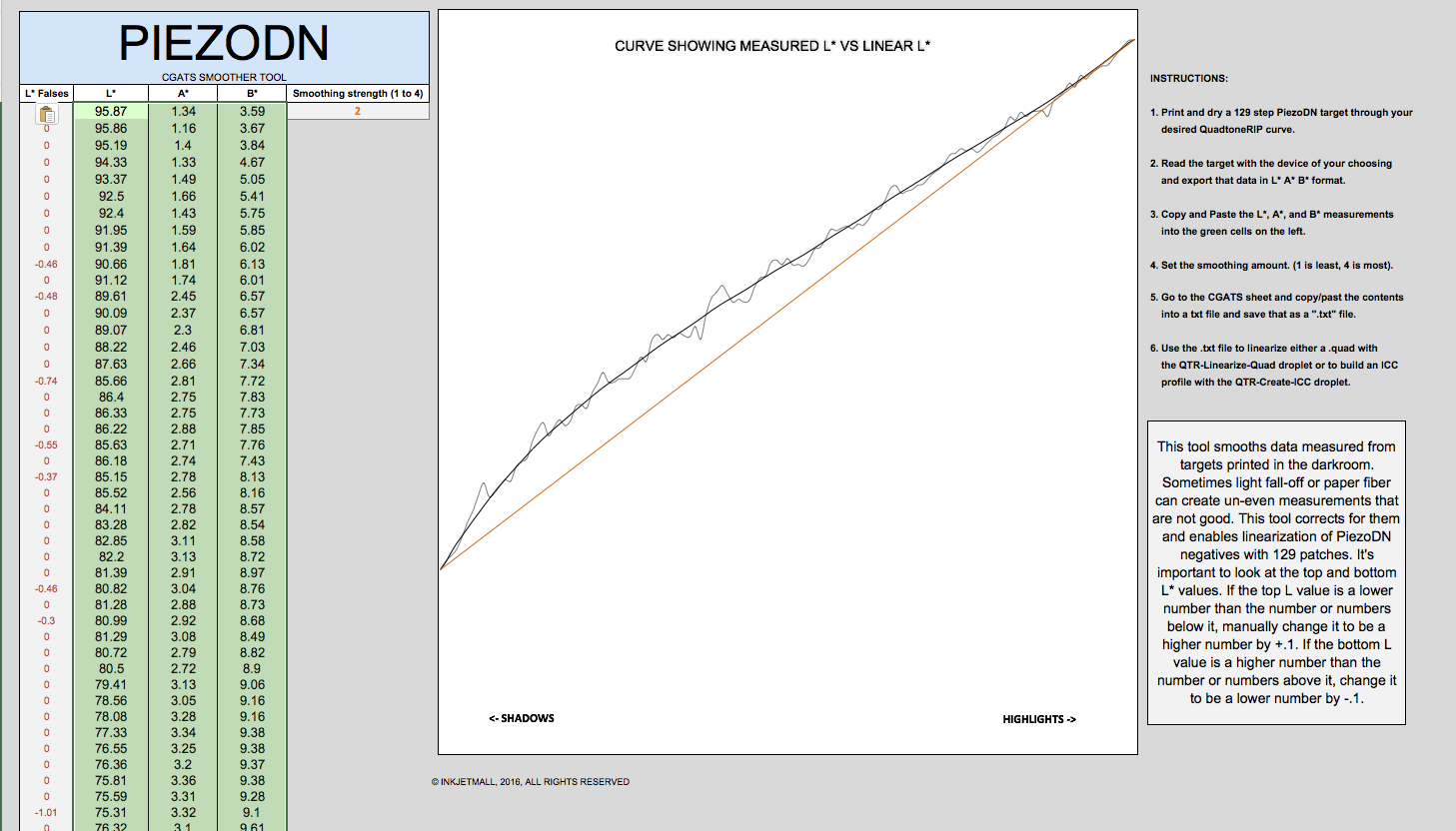

  5. and I then pasted the txt values into the Curve tab in the Excel Smoother file. The CGATS tab is STILL not being populated. When I do this in the Numbers file, the data is in fact populated into the CGATS tab, but the numbers are exactly the same as in the Curve tab. The excel file is not working properly.
[attachment file=29168]

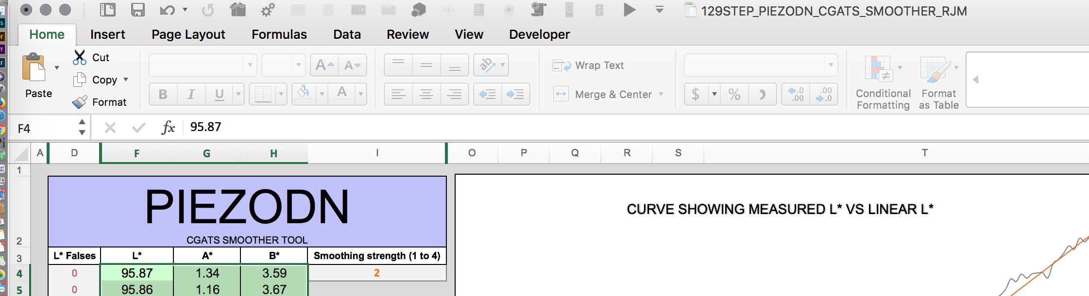

The smoother tool you uploaded to this thread is most definitely not the original smoother tool. It has a different name at the end (RJM) and also has a different color of background on the header (purple instead of blue). Looking through some of the metadata it looks like it was used with a different application.
Again, this tool requires excel to function properly. Are you using excel?
The only reason it has RJM at the end is because you asked for a zipped copy of the file and when I saved it I saved a copy with my initials at the end so as to not save over the original. I deleted it immediately after saving it.

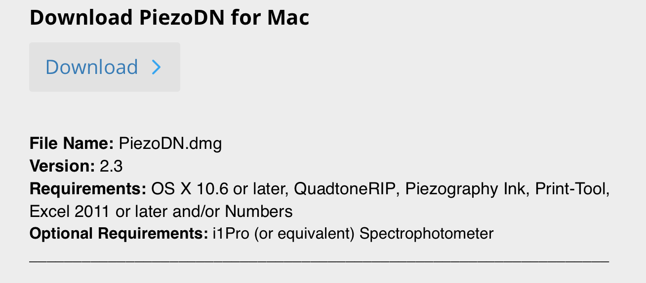

Just to check if maybe something had changed in the download since I last updated (it hasn’t), I downloaded and reinstalled PiezoDN v2.3 for Mac. The Smoother works fine. From what Walker noted above, it looks like you somehow saved a copy, maybe without realizing it, and that is what you are still using. What version of Excel are you using?

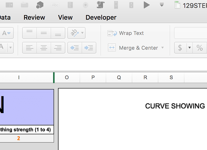

2008, while old, has worked reasonably OK except for the resolution issue on a brand new iMac with retina display.
Yes, yes, as I said, I am only pasting text: paste special/text

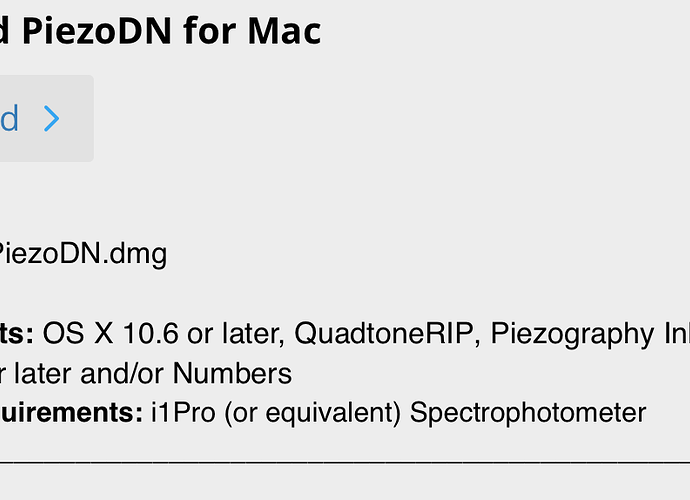

PiezoDN requires Excel 2011 or newer though. It has always.
[attachment file=29180]
Well, now that’s a problem. $99/year for excel for only this purpose seems kinda steep. Can’t I just use Numbers as the spec says?
