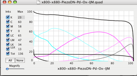

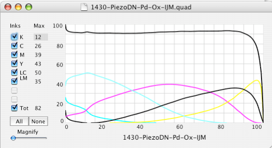

that’s right its an optical X-Rite 810 transmission. BTW I also tried outputting to a different 9880 but with a carbon inset. But is sharing the same shade 1 black from the same bottle and output virtually exactly the same. See attached screen grabs from QTR-Curview of the 1430 PD vs 9880PD quad curves. The 1430 has the K channel fully outputting throat the curve where the 9880 ends abruptly. Does that mean anything?
